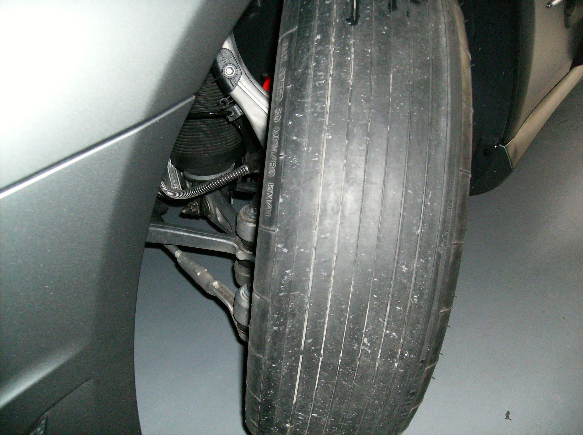

you can use the 19" amg collapsible spare .part # 2304012702 Heres on ebay item 204227447109
And a 211 583 06 15 jack or a 203 jack or several others are the same I dont remember which I have. Maybe for a G or a M
I carry a 1/2" short breaker bar and a 6" extension and a 17mm 6pt socket

Not 100% sure. But the 19" spare is the biggest they make, and it must fit all amgs. I do not think theres any size difference in the rotor or caliper between normal and carbon brake parts.
Sorry i think the one I shoe is the 5.5" The biggest is the 6.5" and it is wheel # 2304012702
theres a ebay item #
204227447109
You can buy these on ebay for 200-500 but the MB parts price is over 1200.
