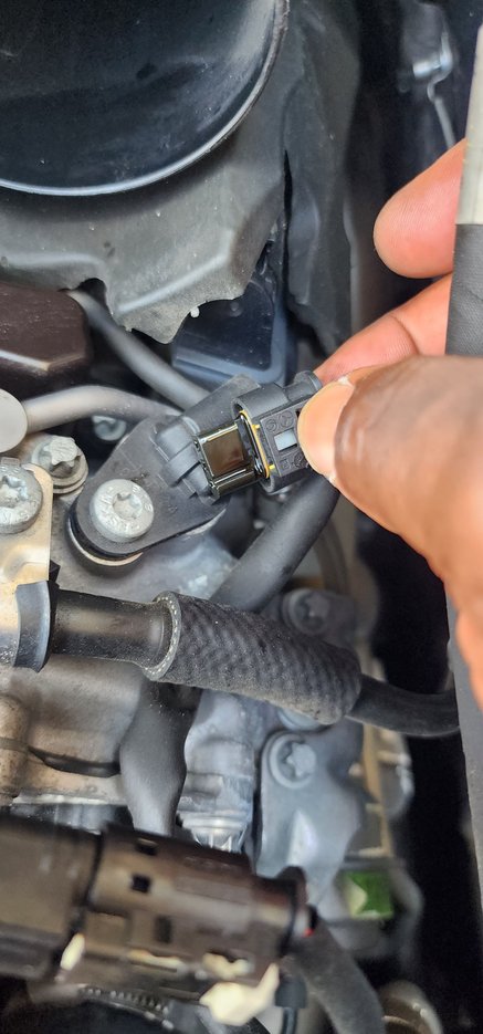

Of the 8 leads that go to my various cam sensors 6 had oil on them..
OIL!
Ordering the FCP kit cam kit. Installed the sacrificial harness kit in the interim.

How many miles? Year of the car? Coupe or cabriolet?

2015 S63 53kmi.Coupe
