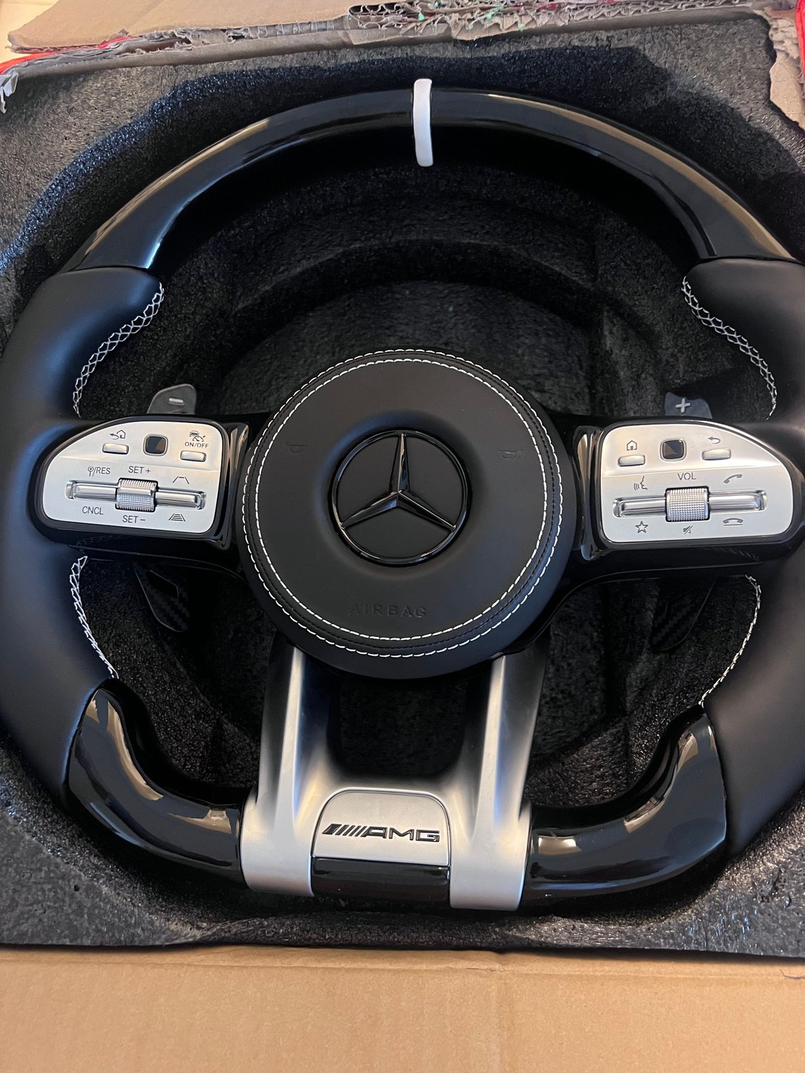

anyone know a shop in jersey that can put this 2018 style wheel i got from ebay on my 2015 63 coupe thanks
this is the wheel i bought

does it have all supporting modules for the retrofit?

i don’t know .. they said i need to change the motherboard from one to another .. i have no idea be honest i just want to bring it somewhere and let them do it lol … if you know anyone i would greatly appreciate it

yeah thats not going to work. motherboard swaps are for like w204 wheel swaps to w205 style. the swap youre looking at you either need a control module or someone will need to wire each button. second option will cost you more than the wheel itself.
reach out to carismo or rucarbon to get a control module. will cost you between 200-300 depending on your options.

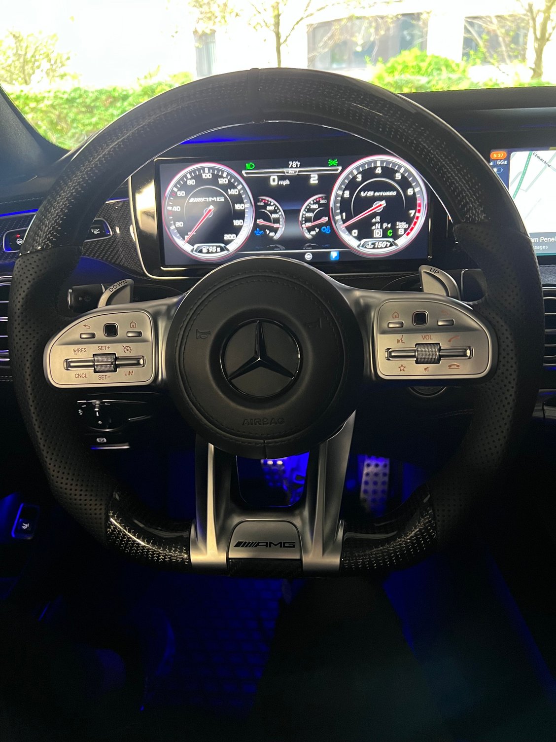

I did the retrofit last year. The seller sent out a wheel that is supposed to be plug-and-play. But doesn't work when it arrived. The seller provided another firmware and it worked after I flashed it in. If you need help for installation or take out the control module/motherboard let me know. I live in Jersey City.

updated new wheel installed
everything works expert lane departure … love it
