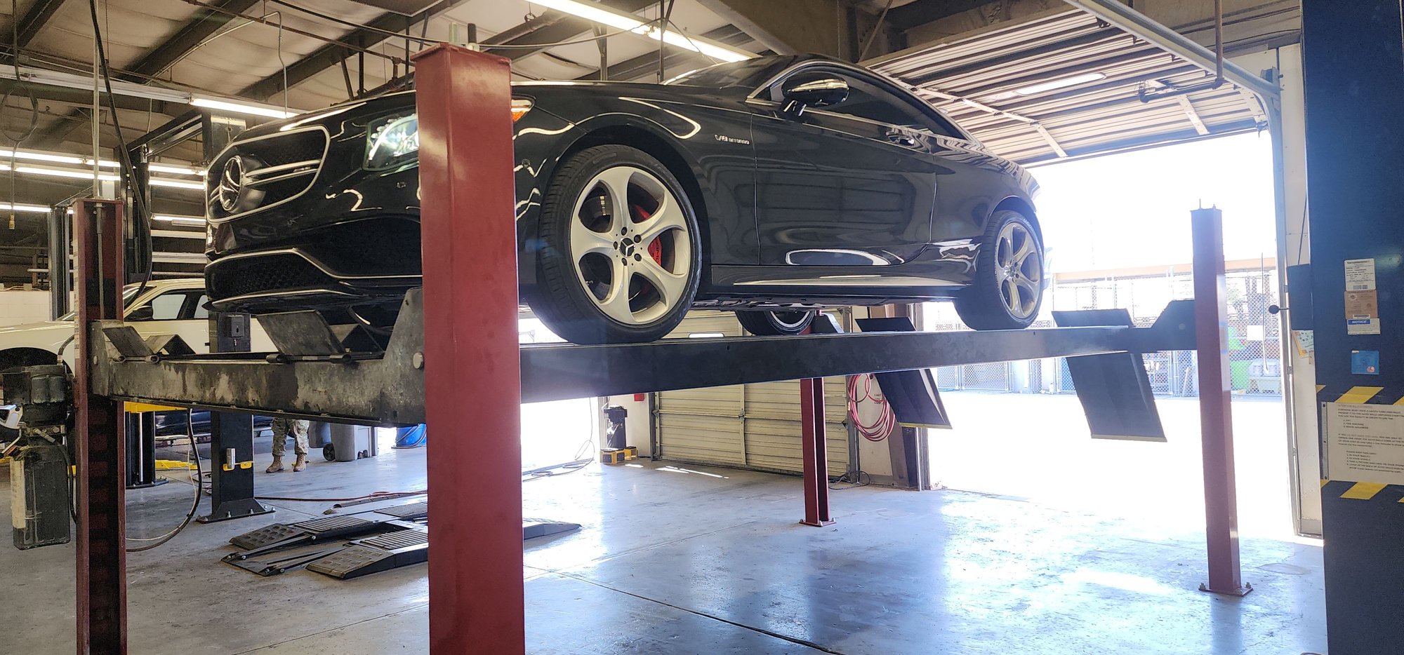

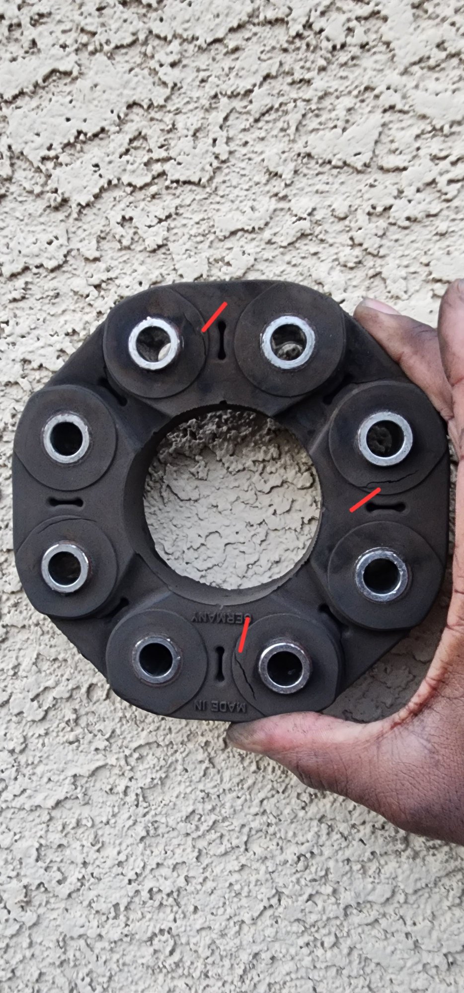

Mine had numerous cracks.
And tears, with a slight clunk when going from park to reverse or drive. 2015, S63 78kmi. The rear one.
The front one.
Saw the rear one while doing a oil and diff lube service.
These flex joints/Guibos can let go with enough force to set off your air bags and destroy everything (like your Transmission) in its vicinity.
