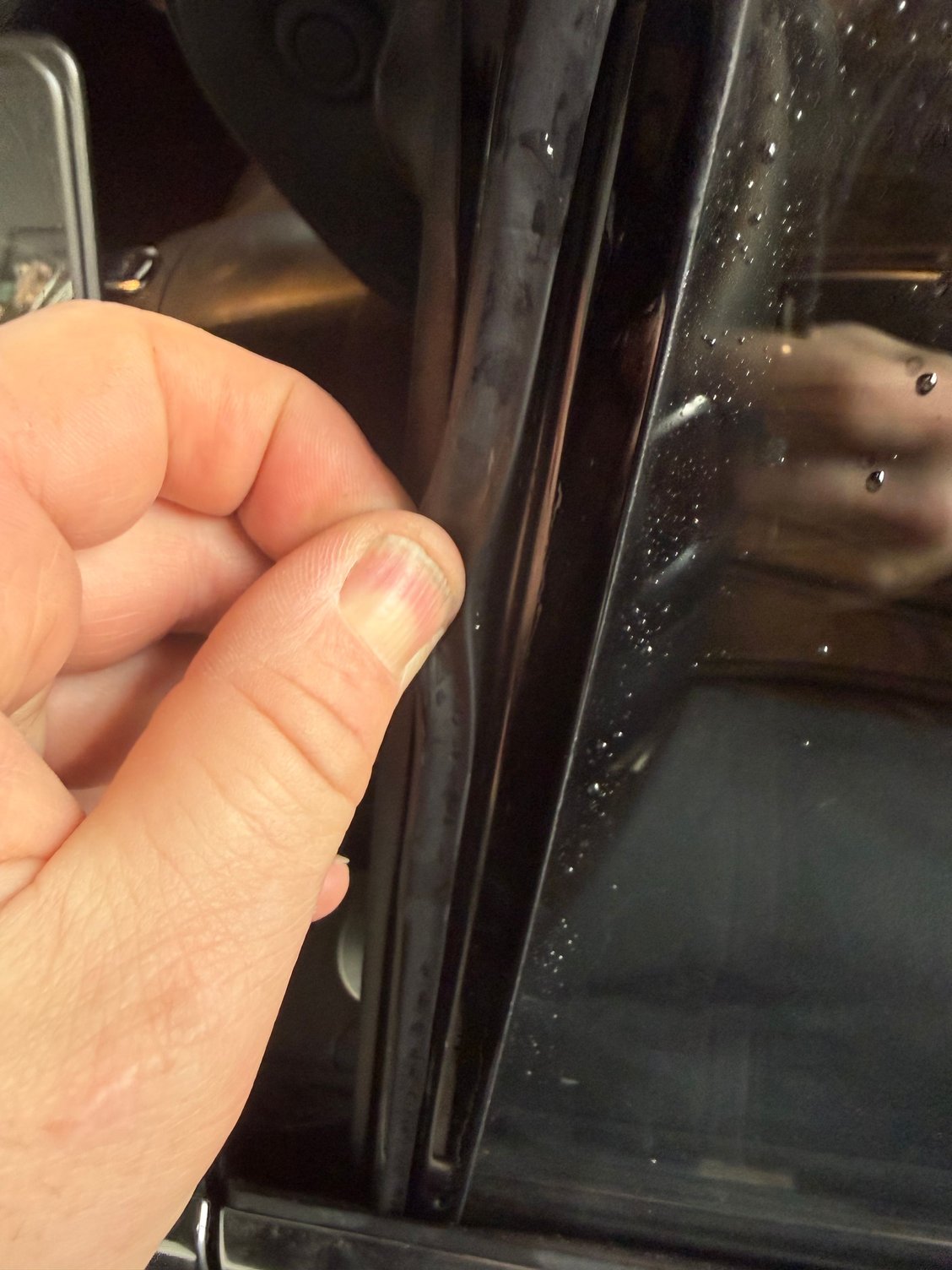

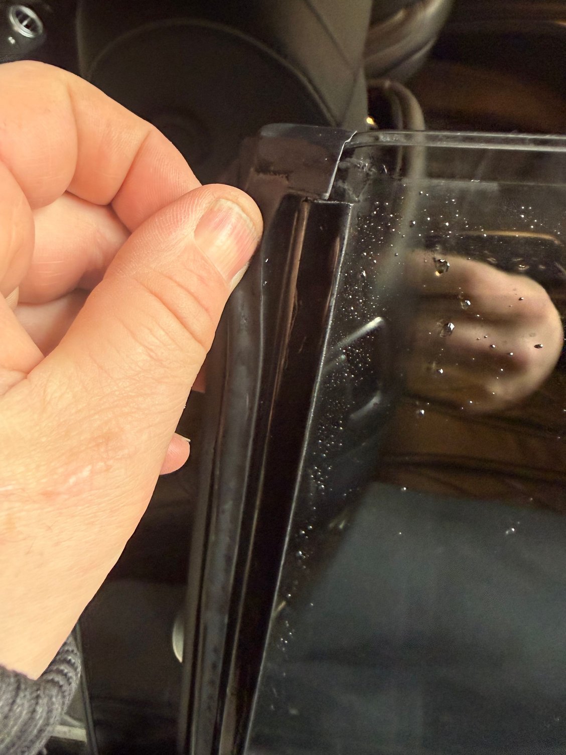

Ok here are some pictures.
The process is really simple.
Open the windows just a little bit.
Pull back the seal on the quarter window and push in the wire all the way from top till bottom.
Make sure you use a black wire, not too thick. If done correctly you can hardly see it, but you will notice that it will push the seal further agains the large window, and eliminate wind noise.
Start at the top
Start at the top
Work your way down
Work your way down
