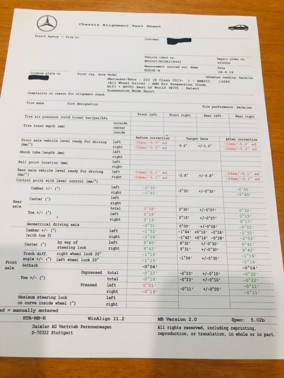

How Do These Numbers Look For A Lowered S63?
As the title states:

It all seems good. If you had the car aligned lowered, like you stated, it will most likely be out of alignment when you drive with it in a normal height condition. I just put new Michelins at all four corners and had my local dealer perform an alignment. The tech did great, and got everything in the middle of the spec. This was with the suspension in normal factory height. I do have a lowering module, however I usually use that for car events and occasionally cruising around the city. However I am mostly set to factory levels. Went with four Michelin Pilot Sport 3. Love them.

For whatever it's worth, I always have the 4-wheel laser alignment checked before new tires: my alignment guy (used to do alignments for Audi race team) looks at tire wear, suspension/wheels damage + queries me about driving habits/preferences, including ride height (I have LoMo unit hard-wired into my 2016 S63V4). Cheers!

Thanks guys for your input. I had my 4 wheel alignment done at the dealer with the lowering module set at low because that is how it’s usually set. It’s all good now.

Does you guy use the holes on the MB rims. I was told only MB could do proper alignment. Kinda of like putting wiper blades on car there is a special alignment tool for them too
