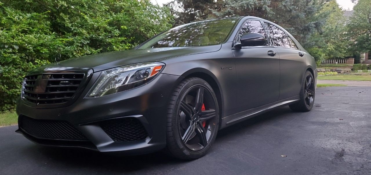

Recently purchased an S63. Pic added below. I got the Eurocharged (EC) ECU tune on it, upgraded the air filters on it, and added a muffler delete. No TCU tune. Car is responsive (and loud), but there is definitely some throttle lag. I'm thinking of getting a Pedal Commander to make the car feel more responsive. Totally get that it won't give me more hp or drastically make my 0-60 faster. But the delay in the throttle response, despite the EC tune, bothers me sometimes when I punch the gas. So is $270 (10% discount) worth it for me to feel that the car is more responsive? I guess if it makes a considerable difference in the throttle response, then to me, yes, it will be worth spending that money.
