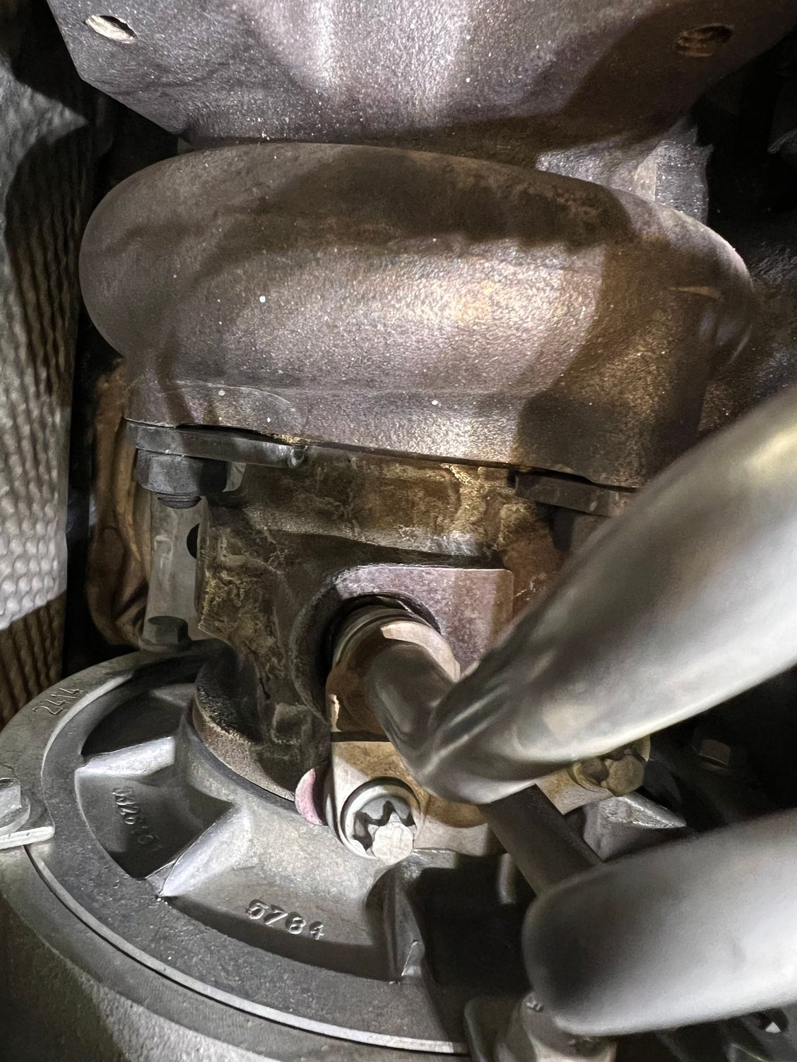

Car asks for coolant every three months.  Some searching reveals this stained mess.

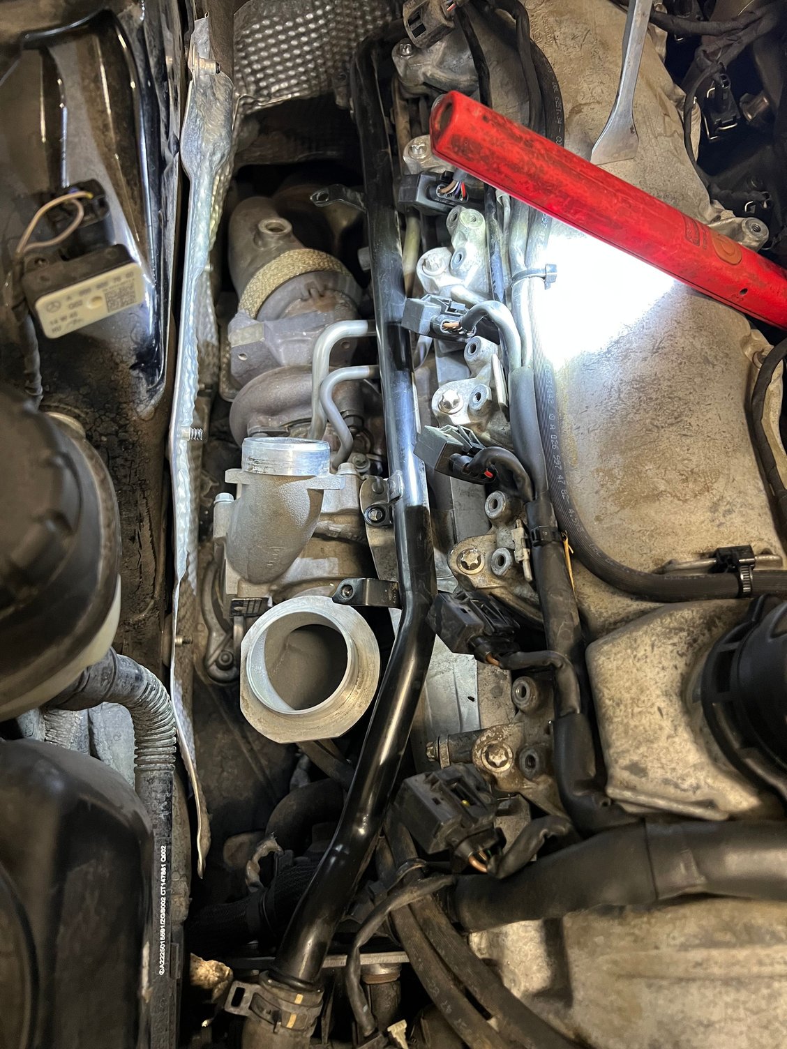

Overview once exposed.

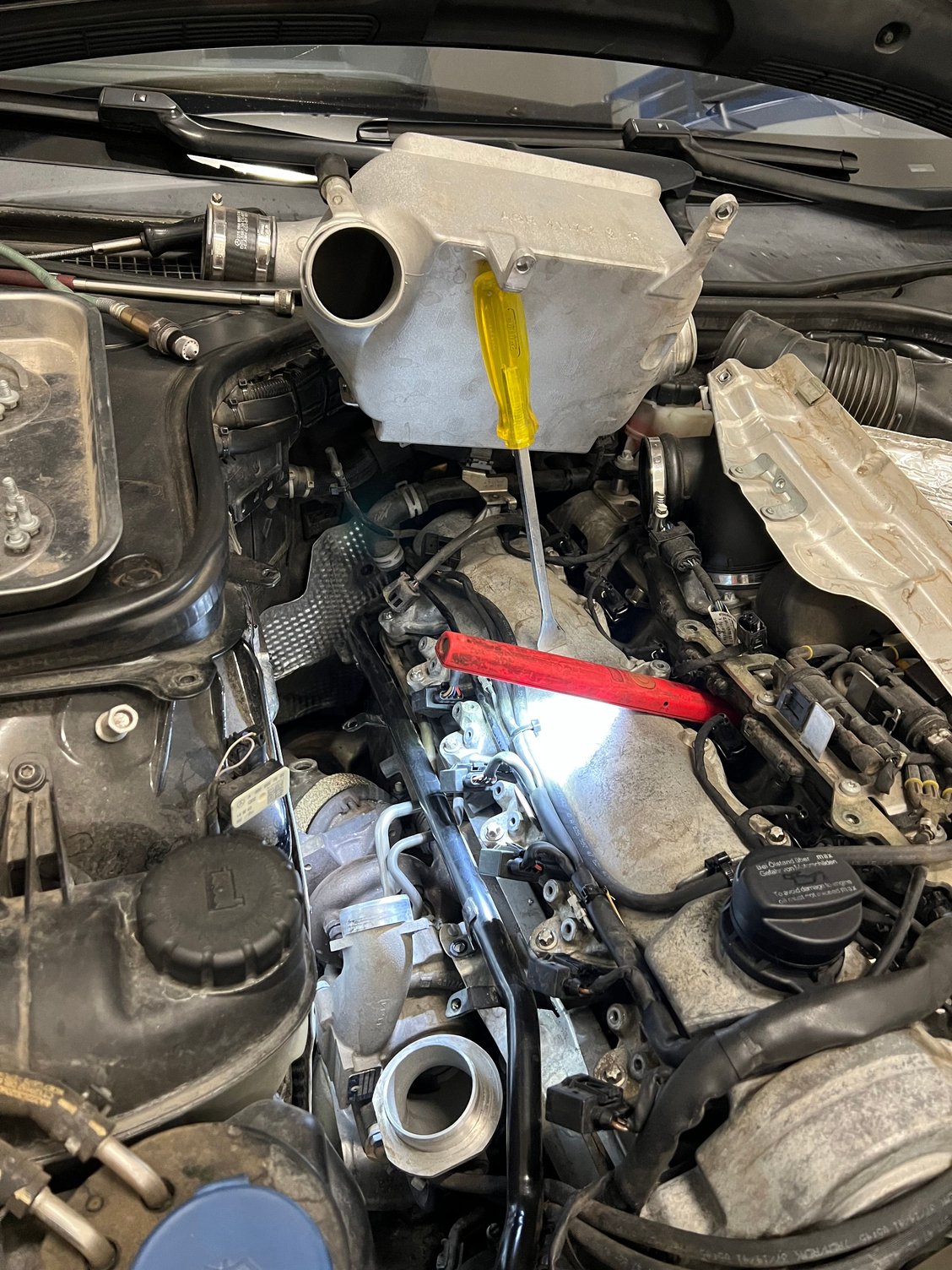

No need to remove the charge cooler.

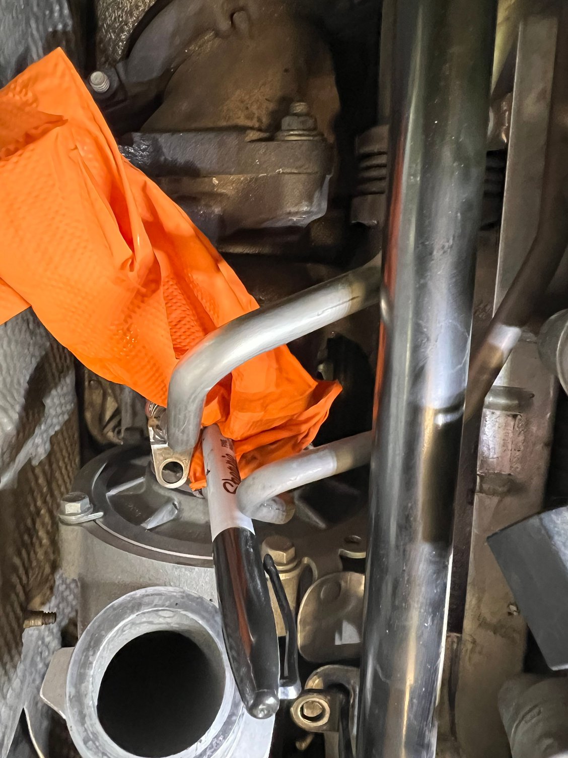

Sharpie and a glove keeps coolant from peeing all over.

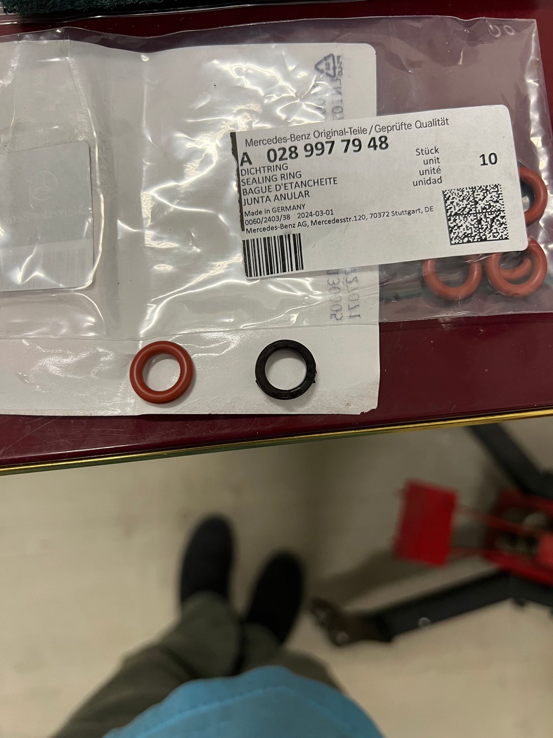

New and old.   Stainless pipe the O-Ring lives on looks as new at sealing surface.
The stainless pipe didn’t want to go back in with the fresh O-Ring installed. Talked to her real nice and everything. Took a bit of carefully applied leverage and time with the pipe pointed straight down.
