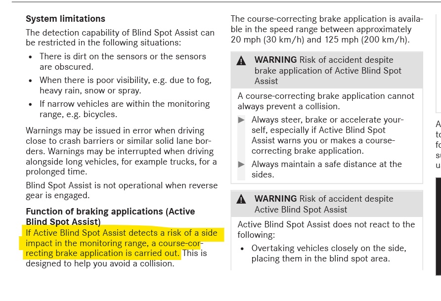

Yes, that's the Active Blind Spot Assist. If despite the warning, the driver continues with changing lanes, it will apply a steering torque in the opposite direction to discourage the lane change and to steer you back into your current lane. It's actually using the brakes. It applies the inner front brake to pull you back. It's all explained in the owner's manual. Time to read it after all these years ;-).
Dude, how do you keep all this info in your head???
I found the video and never knew about this before today:

Haha. This stuff is easy to remember, because the assistants have the word Active in them. Whenever one of these is called Active something, then it isn't just a passive warning system. MB has both, Blind Spot Assist and Active Blind Spot Assist. The former is standard and the latter comes with the Driver Assistance package. So whenever you see the word Active in the name, you know that it won't just warn you, but actively help you avoid the situation.

SUPERSWISS, are you positive it’s the front brake? I thought it was the rear brakes and that’s why they wear so fast these days
No, not positive that it is the front brake TBH. The rear brakes can be used to induce a yaw moment as well. That's not really the main reason why the rear brakes wear faster these days, though. That's largely down to modern cars not having a fixed brake bias anymore and instead the electronic brake force distribution favors the rear brakes when slowing down moderately. In general, the rear brakes engage first, in order to reduce nose dive when slowing down. It keeps the car more flat and provides more comfort for the occupants.
This is the video from Mercedes for the original tech. Looks like it is both wheels on the opposite side of the "issue" or lane.
