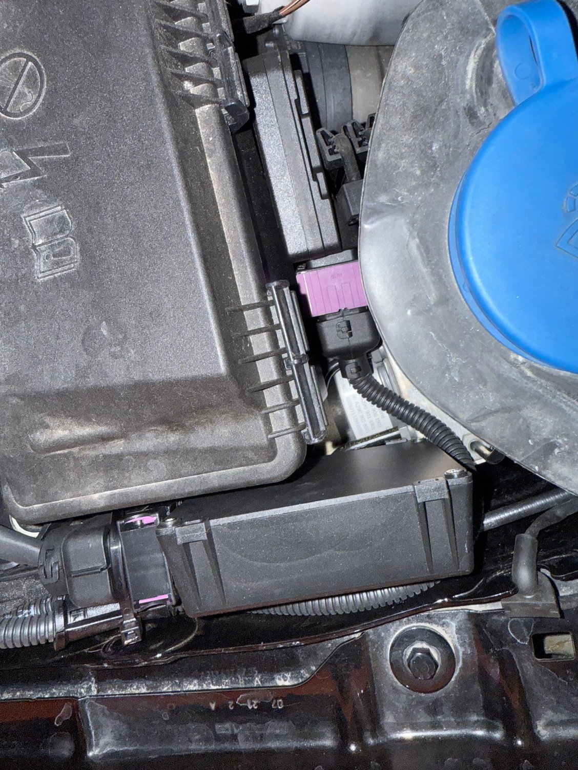

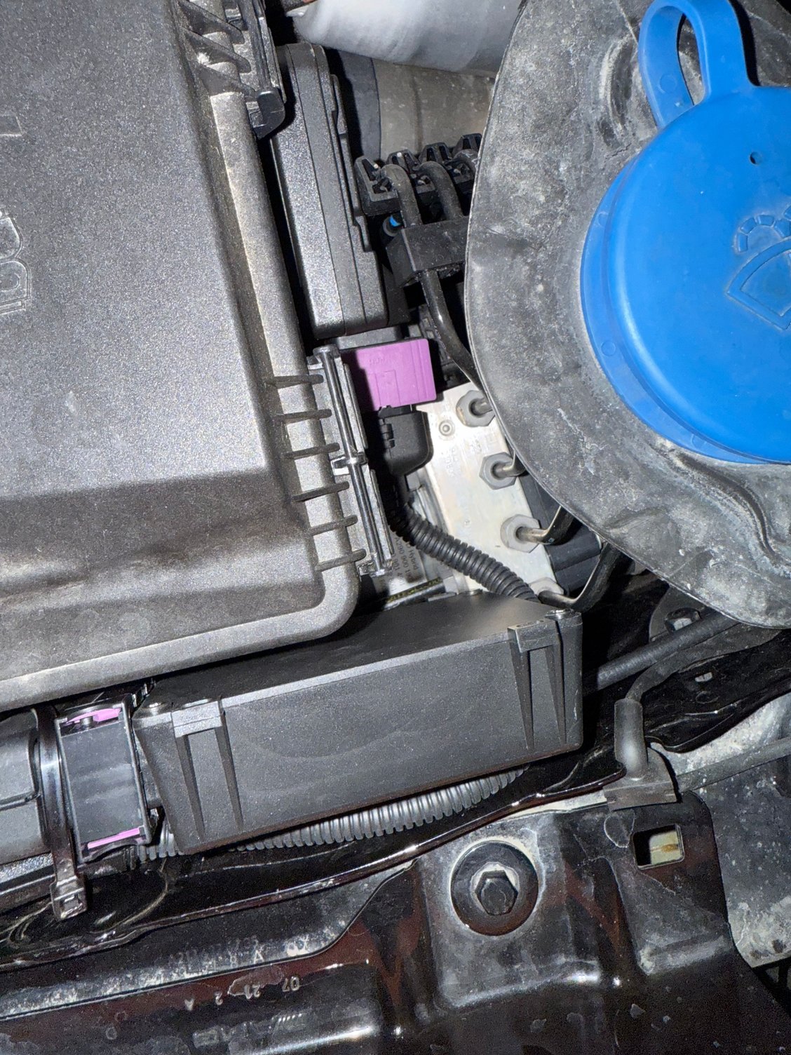

Old May 17, 2025 | 03:26 PM
alexhvh's Avatar
Joined: Jul 2024
Posts: 13
AMG GT4Door 63SE Performance
Originally Posted by sedde
Can you post a picture of the piggyback ?
does it have any branding on it ?
Yes sure here is the picture of one of the piggybacks & seletron emulator , and no only the seletron emulator has their branding the piggyback is just a black plastic box with a see thru glass and a motherboard and leds inside
Old May 17, 2025 | 04:56 PM
sedde's Avatar
Joined: May 2025
Posts: 6
If it’s not that much of a hassle, can I see the piggyback front and back ?
