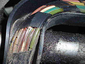

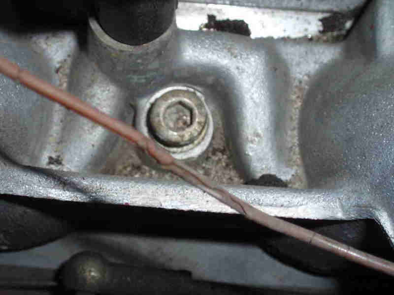

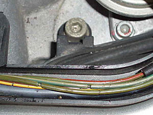

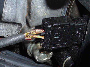

Old Jan 10, 2012 | 04:25 PM
MB-Dude's Avatar
Joined: Aug 2005
Posts: 591
From: Covington, WA
'96 SL600, '05 S55 AMG, '06 C230
Attached are the 'before' pictures of the harness I replaced in a '94 SL500. The throttle actuator wiring was the same condition. This is indicative of the infamous mid-90's harness issues that plague virtually all MB's in that era. Also owned a '94 S320 with the same problem. When the engine wiring harness starts to fall apart, strange things can happen. Your MY is on the cusp of the problem. If you do change out the harness, it's not too difficult a job. The wiring of the throttle actuator can be dealt with easier, separating the few wires with electrical tape… as a temporary measure. Replacing the harness made a world of difference in the reliability of both my 94’s.
Cheers,
Jeff
