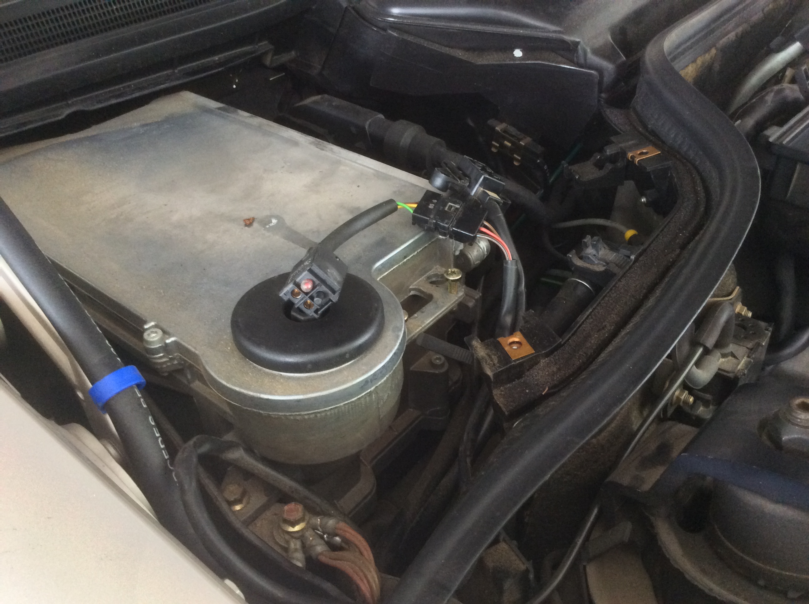

I am replacing the lower engine harness and noticed this disconnected harness. What should this be connected to?
Attached Thumbnails Please identify this connector in '94 SL500-img_0151.jpg

Is there a part number on it?

126 5401 00 44

Sorry 126 540 00 44

Hi, xxx.
It looks the CARB Diagnosis connector (with one LED und one button).
