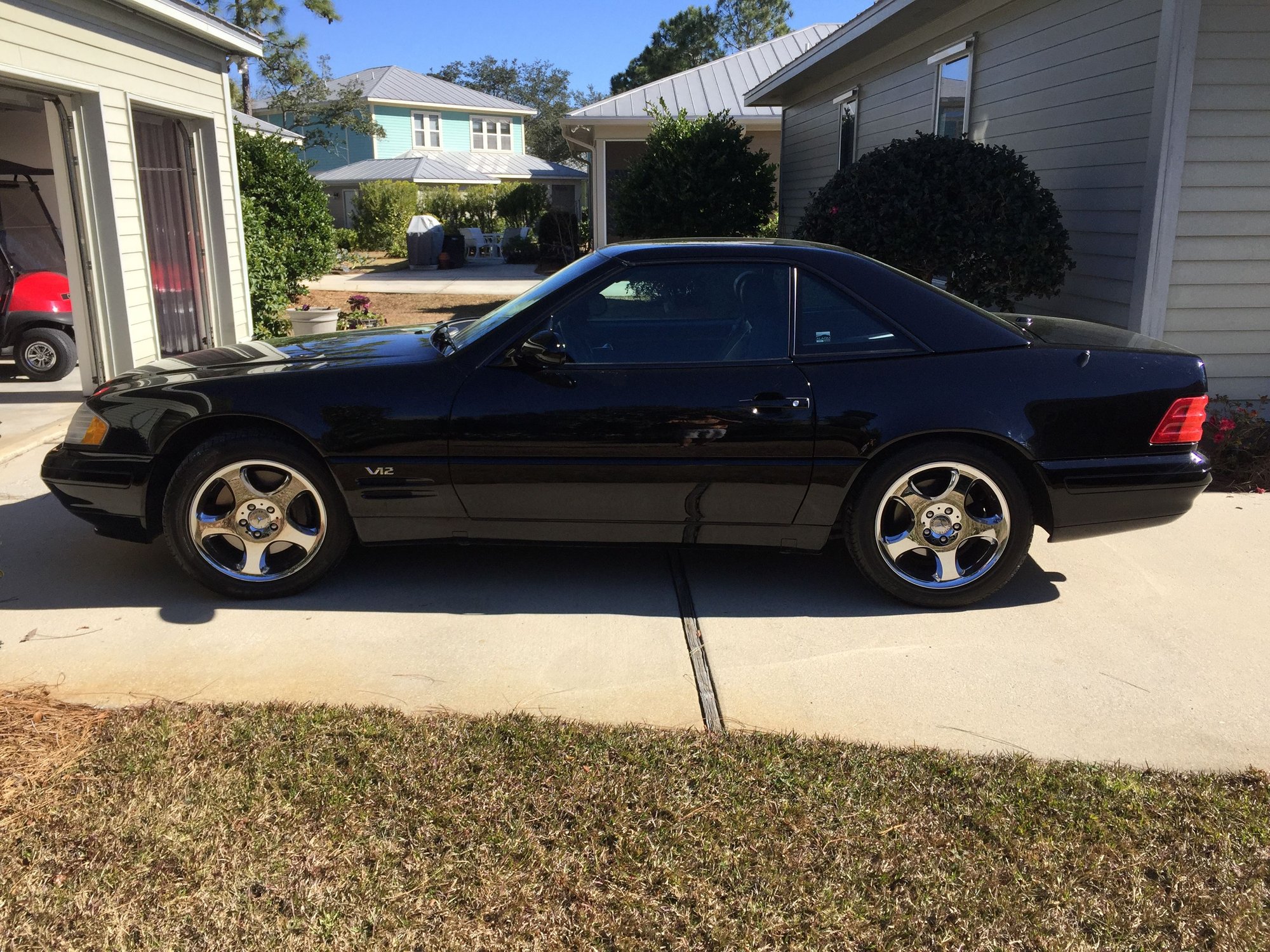

2000 SL600 For sale
As much as I know that I will regret this decision, the SL600 is up for sale. 43K with all the paper work, 2 keys, K1Radar system, custom cover and storage rack. I have clean Illinois title and Carfax. Have many more photos and video, that I will send if anyone is seriously interested. thought I'd check here before listing on BAT. Vehicle is currently garaged in Alabama just off I-10.
PM if interested.
