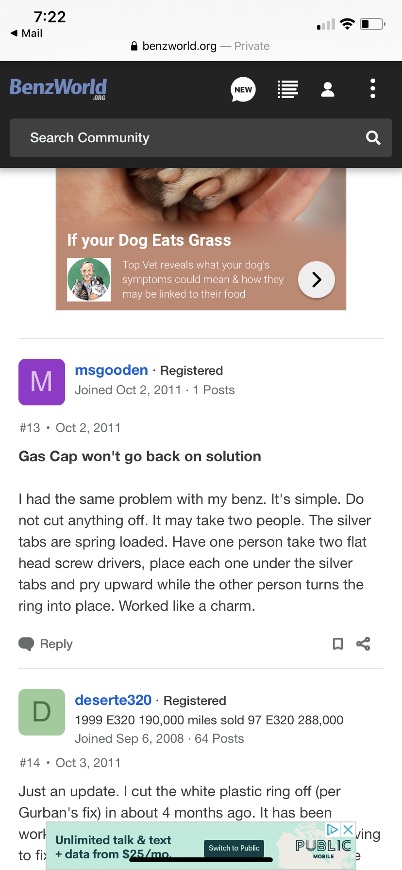

I unscrewed the cap and could not screw it back on. It was like a bad dream ... on the side of the road, in the middle of no where & can not screw the gas cap on.
I noticed there was a strange miss alignment of the tabs on the cap. Like this image off the web ...
Fortunately we were able to Google and find a fix. The metal tabs need to be prayed up & the plastic ring needs to be re-aligned.
my wife & I used found objects (pop and beer cans out of the ditch) to accomplish this ... but we did it.
The gas cap went on in normal fashion - the gas gauge stopped blinking. The Check Engine light did not go out. But we continued to drive 3 hours through a mountain pass at highway speeds with no problems.
So I am thinking now - it was not some fuel pressurisation problem - but a gas cap age problem. Just need to reset the Error codes.
