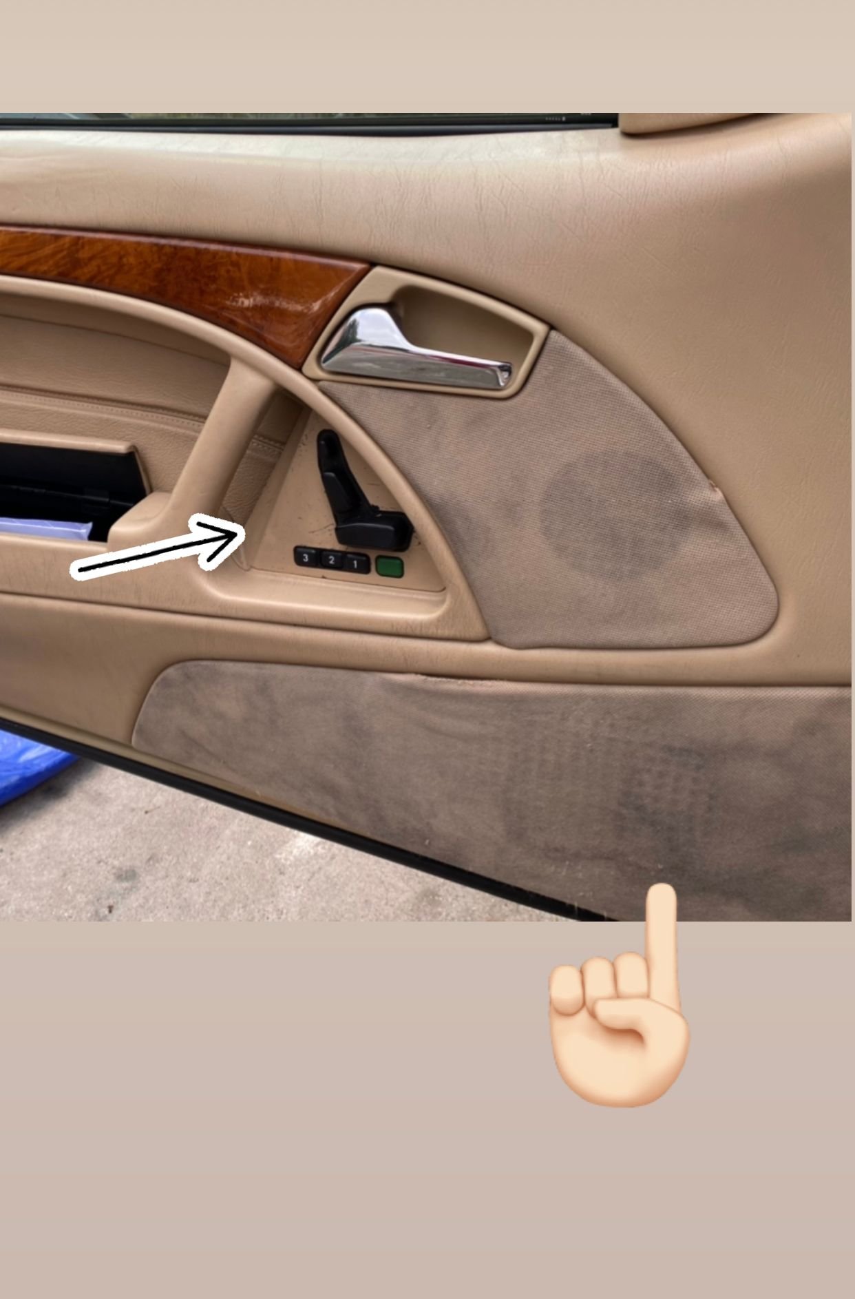

Hi guys,
Do you know of a SEM vinyl paint color to touch up around the seat adjuster and how to replace or clean the mesh cloth on the speakers on the inside door panels.
I don’t really want to take the door panel off.

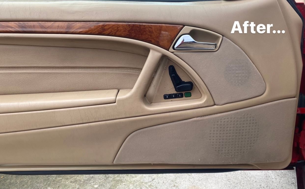

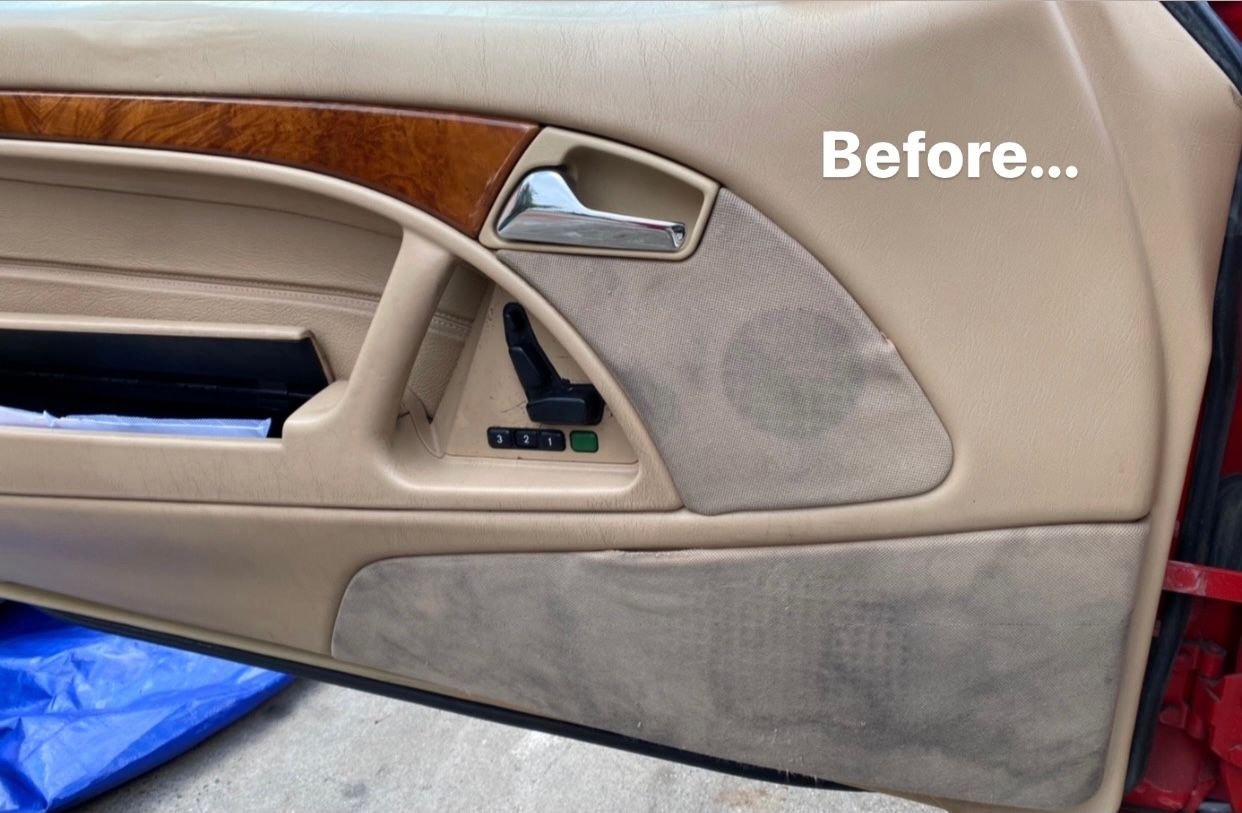

I cleaned the speaker grill mesh yesterday using Resolve suggested by Mahunt. I sprayed Resolve on to the fabric without directly spraying on the speaker. I used a damp sponge to go over the speaker with the excess from the parts I sprayed and let it soak for 5 min. Then I took a damp microfiber towel and gently brushed the whole area. I rinsed the towel and went over it again 3 times.
Here are some pics. I will clean again today.

That's looking better.
Resolve is a wonderful product for soiled car interiors. It does a great job on the carpeted portion of the door sills too. Just carefully remove the door sills, spray with Resolve and after 5 minutes you can rinse them clean with a hose. You wouldn't believe how black the runoff is. It usually take 2 treatments before they rinse clean.
Did you just tuck the loose grill material or did you re-glue it on the backside?
Tell me you took the lower speaker grill off to clean and repair.
