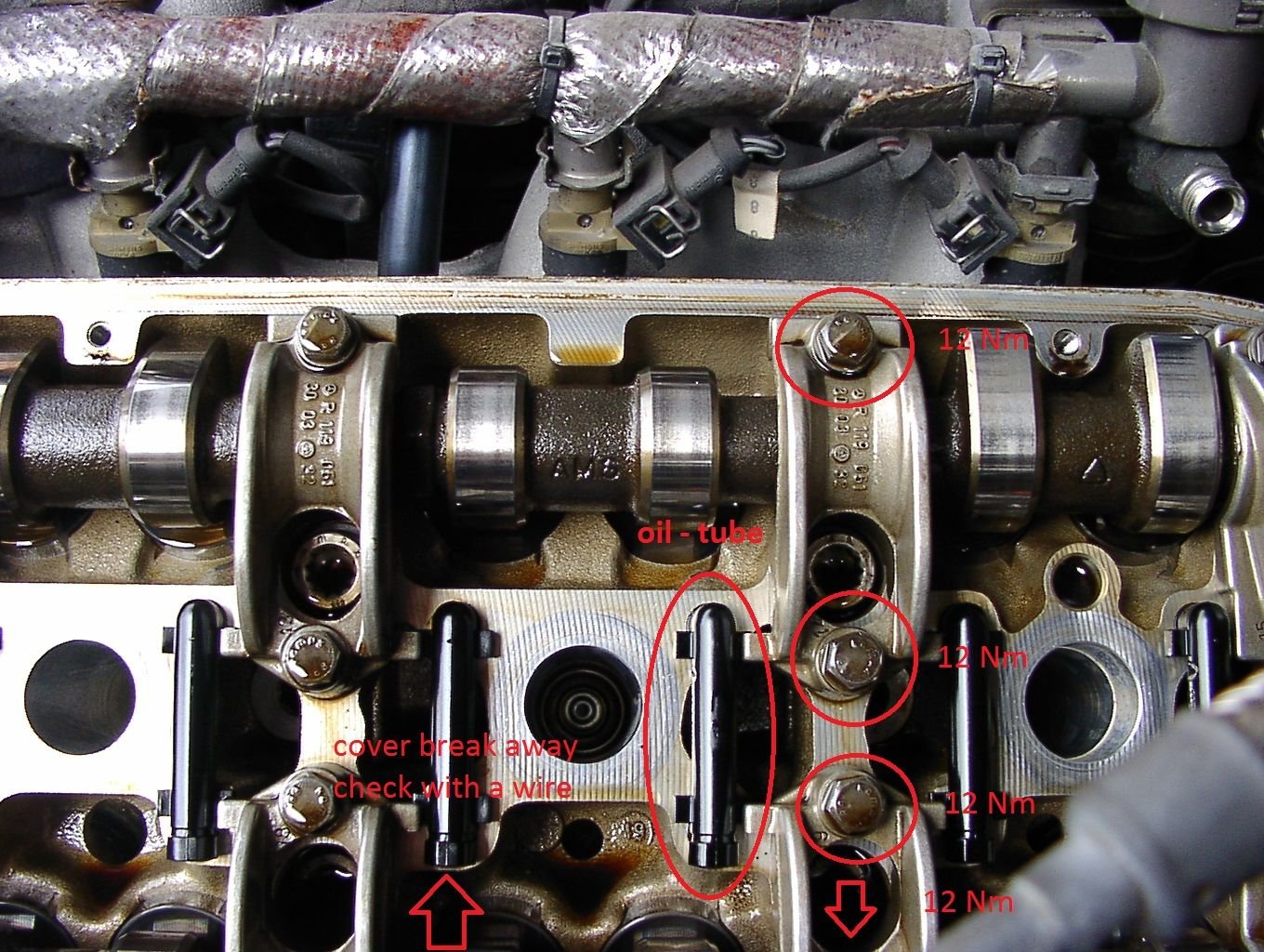

Can anyone offer a video or guide to replace the camshaft oilers as well as the upper timing chain guide?

Thanks for this.
What does "Check for a breakaway" mean?
Also, any info on replacing the chin guide while I am in there?
