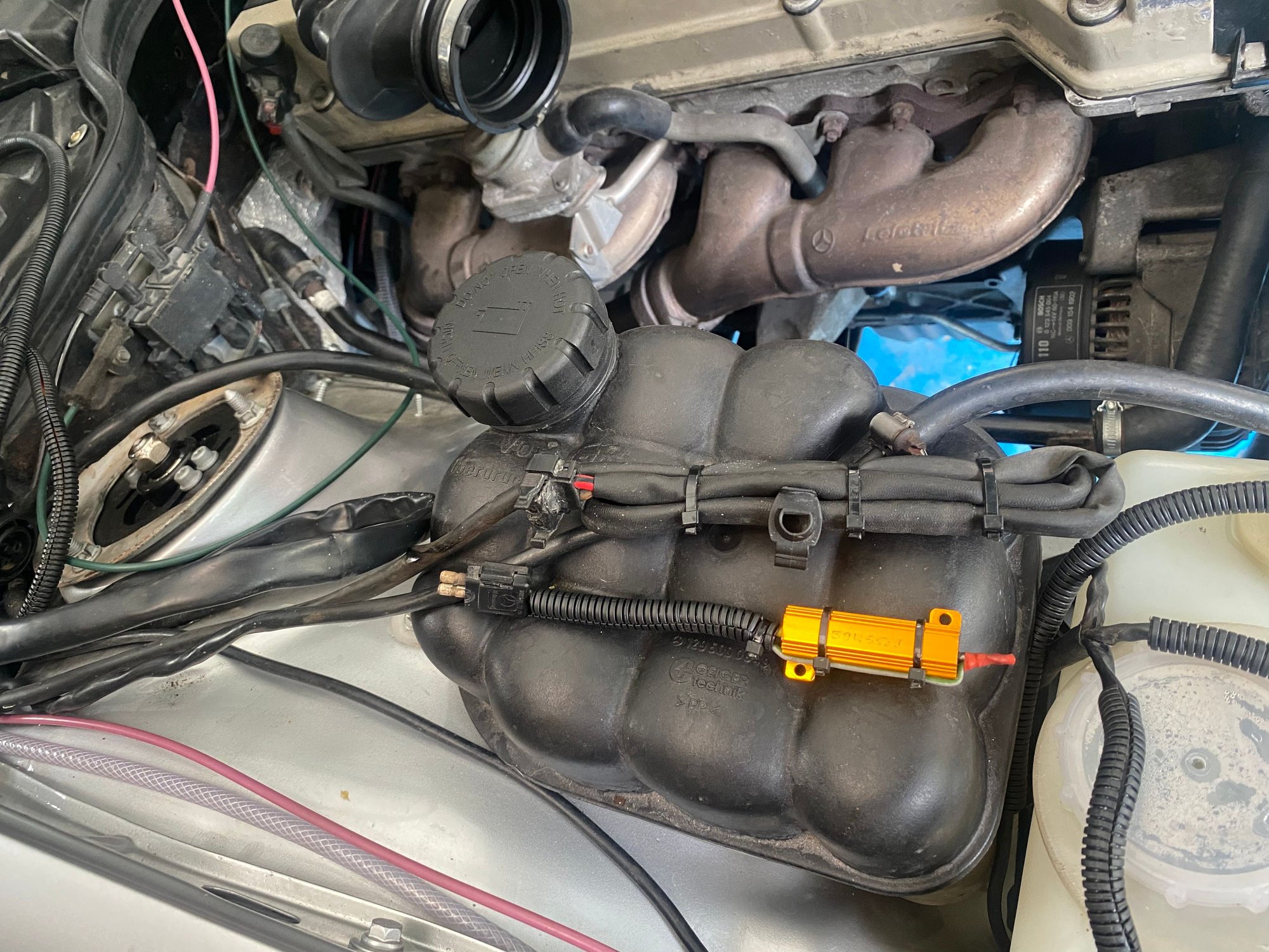

Decided to delete air pump. M104 95 SL320.
I learned that to fool ECU about this procedure ,one should install an 5 ohms 50w resitor. I did that and plug in. The point is that that resistor get REALLY HOT , will burn my fingers in a matter of 2 minutes. What u guys think? Perhaps 100 watts? Different ohms resistance?? Tks a lot.

Not too diffucult but new parts needed. Removing the air pump is straight forward but you will need the proper alternator bracket with diferent pulley setup pn 1041550635 and a new shorter serpentine belt.
