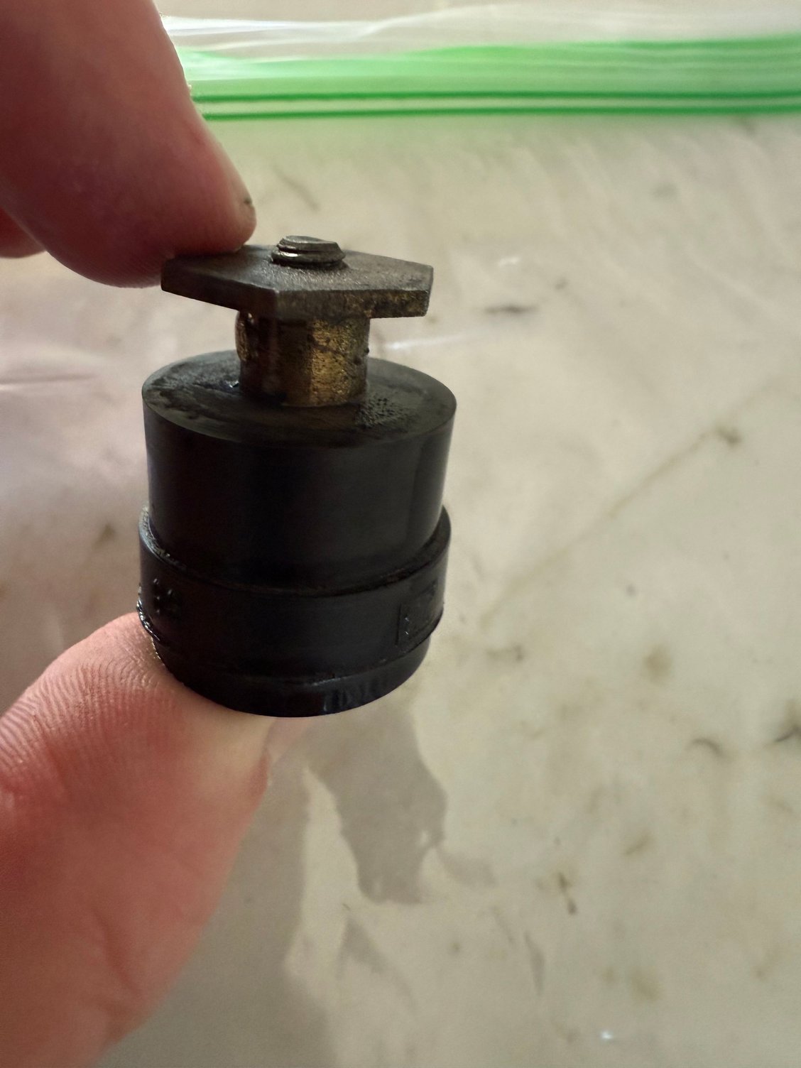

Anyone know the part number for this “stud” with the rubber isolators that holds the airbox down at the rear?

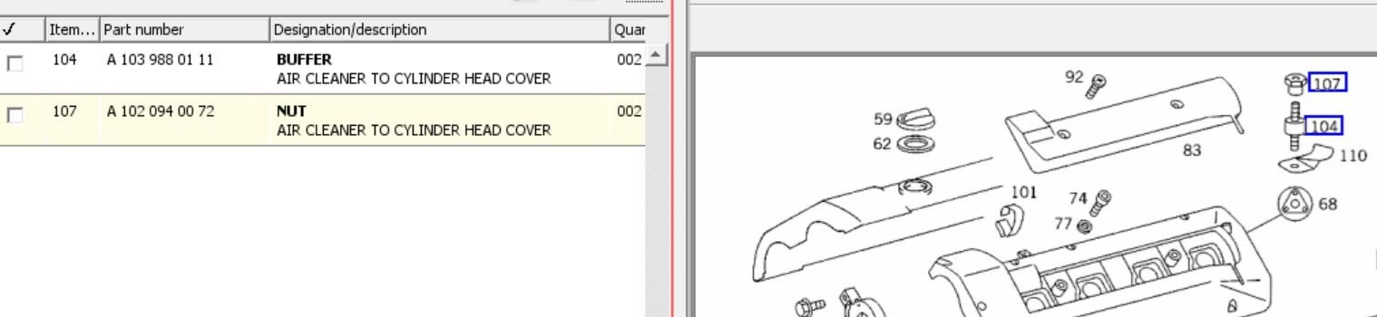

R129.067 (500SL '93), EQE, MGB
Buffer & nut
Buffer & nut
