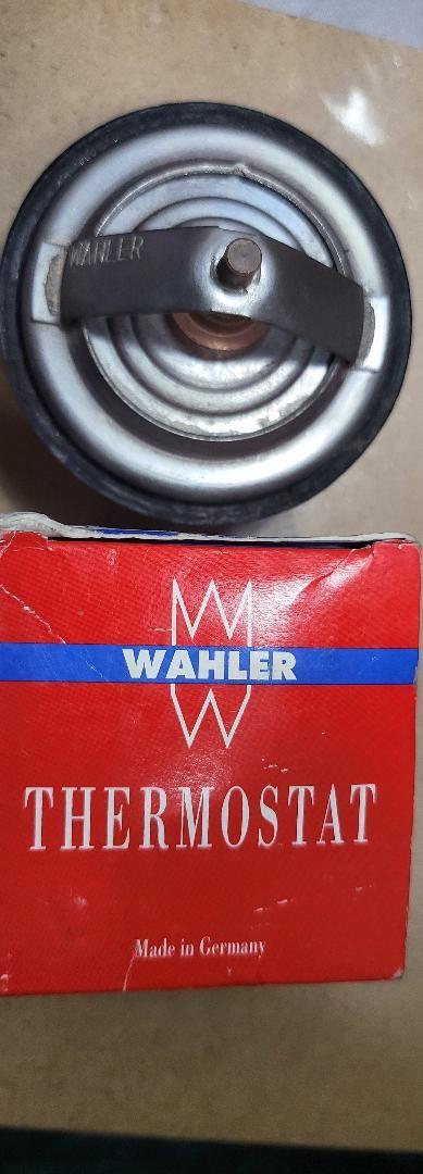

A.H.
My 300SL is equipped with the 300-24 motor.4 valve.
I have currently installed thermostat [71C, rated] made by and directly purchased from Wahler Manufacturer unit and labeled accordingly. It does not have any Mercedes markings as when marketed for them.
Attached pics of Wahler 1] 71C 'stat. (currently installed) and 2] 87C 'stat. (previously removed).
71C Wahler stat
71C Wahler 'stat
71C Wahler stat pic2
71C Wahler 'stat pic2
87C Wahler stat. pic1
87C Wahler 'stat. pic1
87C Wahler stat, pic2
87C Wahler 'stat, pic2
The 71C 'stat does NOT have some holes, in the body, you describe. Will modifying it suit the case?
HZ

AndreasHannover's Avatar
Joined: Oct 2017
Posts: 369
Likes: 73
SL600
This is the vent opening, which must point upwards when installed horizontally.
For me, there are two reasons for overheating: The wrong thermostat with a different shape, opening one but dont clothing the other circuit. Or you replaced the broken radiator with an other broken radiator.

hifeverz's Avatar
Joined: Nov 2008
Posts: 21
From: Cali
1990 300sl, 2004 E320, 2015 G63 AMG
AH.
Thanks for comments. My observations to those . . .
The 87°C 'stat, as you noted[encircled] is a check valve with a small sst ball . . . for air release passthrough. The 71°C 'stat has a small vent hole in lieu of the check valve. The position is mute as the "stat is mounted on a horizontal plane, ie NO position on its circumference is elevated.
Radiator: The 2, I purchased are OEM Made in Germany, Brand New units, both purchased from FCP Euro. . . and IMPOSSIBLY "broken".
Any other suggestions, comments are greatly appreciated.
I still feel that allowing a commercial indy to pressure chemical flush may help. As I previously noted, I've used such a service on another vehicle with positive results. And that is my future endeavor.
HZ
Joined: Oct 2017
Posts: 369
Likes: 73
SL600
Good luck. But still: The mismatched 71°C doesn't help and doesn't work, don't you think it could be the culprit? I(!) would correct that first. Although, I actually have a cheap thermal imaging camera, so I would definitely use that first to search.

hifeverz's Avatar
Joined: Nov 2008
Posts: 21
From: Cali
Wouldn't hurt to try another standard MBZ OEM t'stat. . . . I'll do so and hopefully may see better results. My initial thoughts . . . that differences in these items are have NO basic differences . . . other than the temperature rating.
Can you please, clarify to me What design/operational differences, perceived, that should change output? . . . as the 71°C Wahler t'stat is a standard dual valve [primary, secondary] designed unit that fits properly on its designated seat mount.
My car is 35 years old and had a 35 year old designed t"stat. . . . to my thinking, the latest design is NOT necessary to achieve normal operating temperature, . . . since running normally in the last 34 years!?
Joined: Oct 2017
Posts: 369
Likes: 73
SL600
I replace thermostats on (almost) every new, old car I buy. They age and no longer reach the end position or close completely. A valve that doesn't close completely is like no valve at all; the water no longer takes the entire route through the radiator but flows directly back into the engine. There was never a 71°C thermostat for this engine. Just because it fits doesn't automatically mean it will seal.

dolucasi's Avatar
Joined: Mar 2016
Posts: 1,371
Likes: 195
From: SF Bay Area, CA
190E 2.6L 1989, 190E 2.6L 1988, BMW 535dXdrive 2014, BMW 428i 2015
I should add that you will need to replace that 71 degree thermostat anyway if/when you get your cooling problem fixed. You will need a proper 85c-89c thermostat.
Otherwise it will be difficult for your emissions system go into closed loop with at "working" 71c thermostat. The Closed loop operation is tripped ~ 75C-80C. Anything lower it will operate open loop.
I know you are far far away from this problem currently but may as well put in an proper MB thermostat and be done with it. And then continue to chase the source of the overheating problem.
