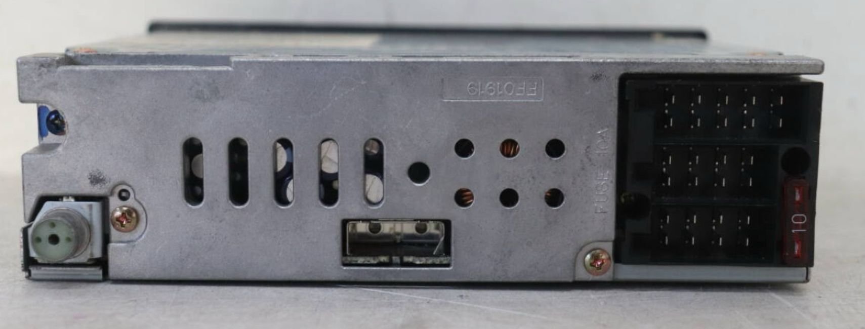

Hi. Does anyone of you know how to or have any guide / manual of soldering Bluetooth module into Becker 33** radios ?
thank you.

Most of those Beckers have the 2x5 pin rectangular connector for CD and AUX inputs. If so the simple option is to hook up a BT adapter.

you mean the top right one?

Yep. But since I have no hands-on experience with BE33** radios, cannot say if there are BT dongles compatible with those models available.
