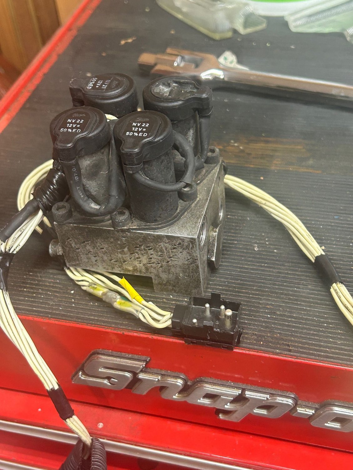

1998 SL600
Looking for info on the suspension height control value.
MB dealer told me its no longer available however their website no longer shows correct part numbers for R129s.
When I looked this part up a couple months back their website was showing correct R129 numbers and did appear available.
All reference material I can find refers to Y36/6.
Looking for part number and maybe a used part.
Any help would be appreciated.

The one in your photo has had its wiring replaced, which might be the problem.
From my experience, a bunch of the control valves were made with the old degradable wiring, mine was. I bought a new one (back when you could), but one of the solenoids was bad from the get-go. I swapped one of my old but working solenoids to the new valve block and have been using it ever since.
I do have another valve block available, but you would have to swap one of your solenoids to make it work. The wires are thin, but not too hard to do; I did.
If you do have to go the used route, make sure you see the condition of the wiring first before buying.
