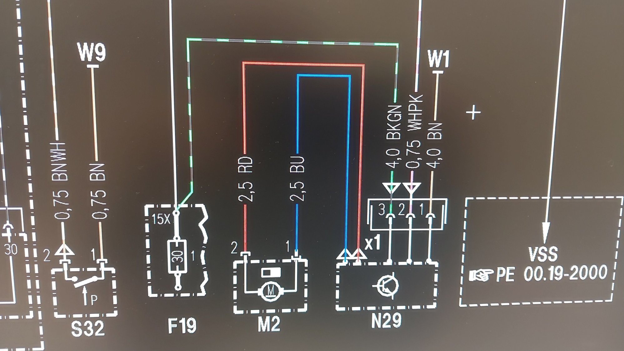

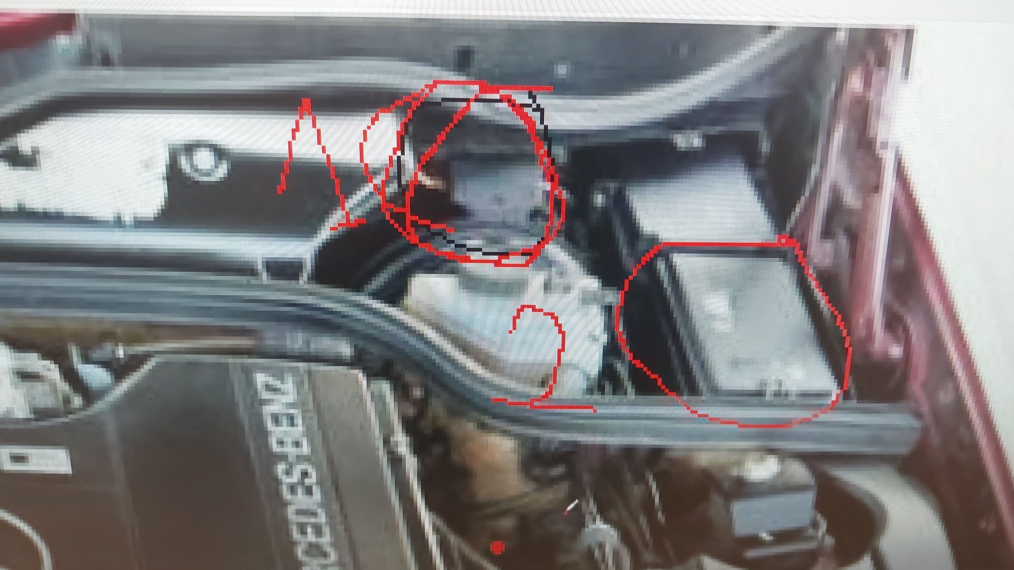

Hello. Resisior is ok. The problem is that: the plug of the regulator has voltage but no intensity. I cheked the electric diagram and i have to find the F19 ( front auxiliary box) and the fuse 15x. Do you know where are this parts? The blower motor is M2, the elwctricity is coming from the regulator N29. And the positive is coming from the F19 fuse 15x.
Is the 1 or the 2 of the image?

Hello,
also in the box number 1, there is no itnensity.
Best REgards.

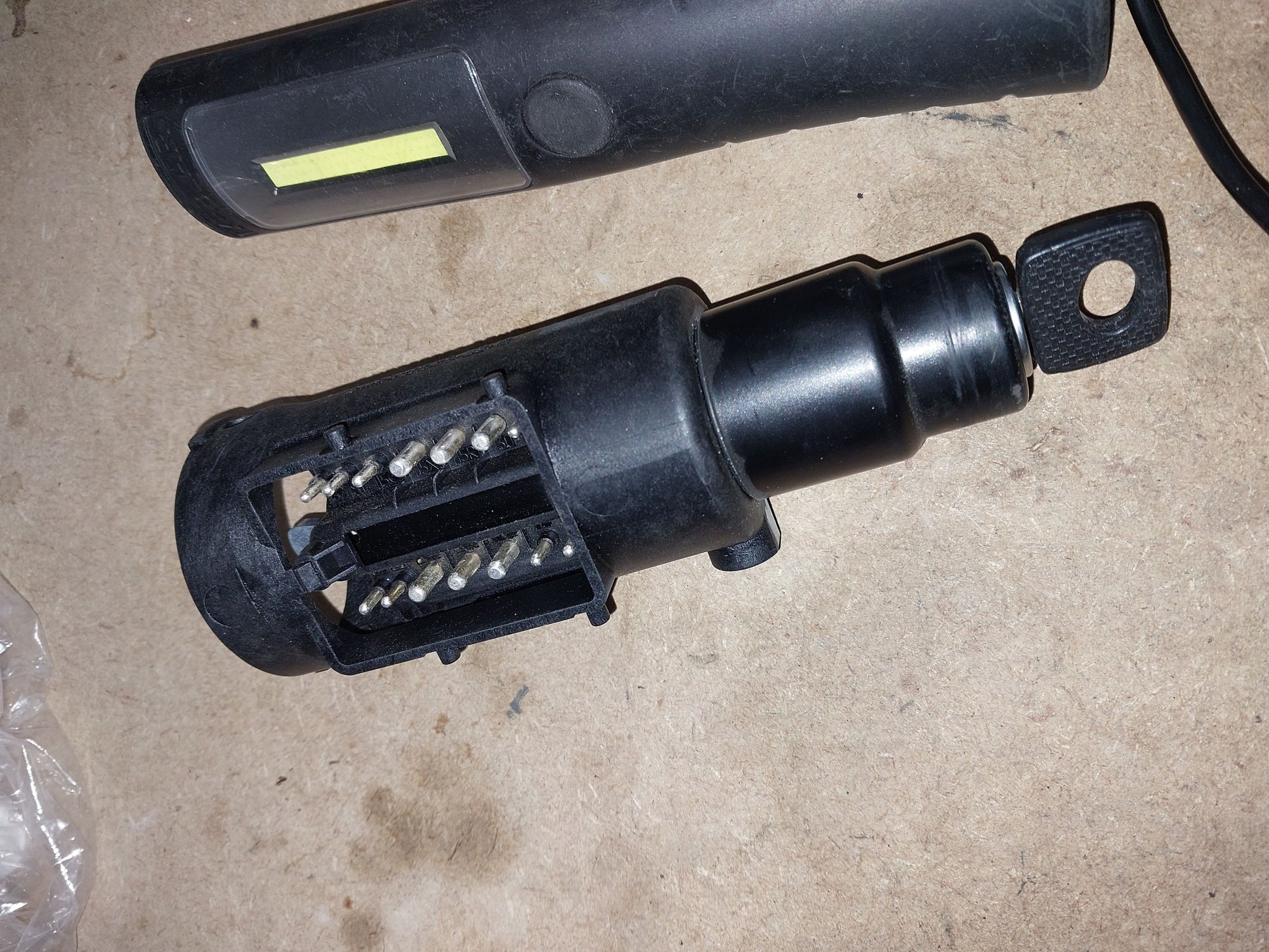

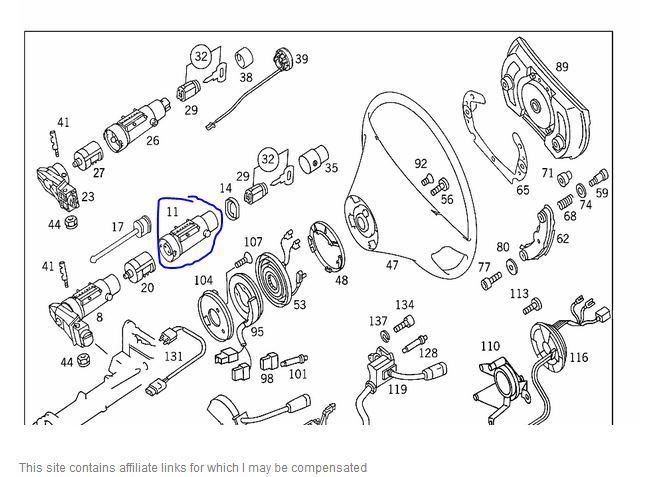

The problem is the "clausor". It is the part 11. Bad contact. ( open de rear part of the piece and sand the contact areas. Works perfectly.
