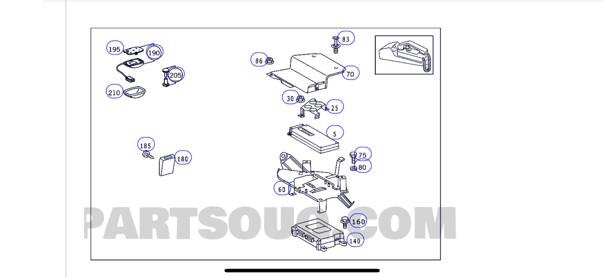

My car is 2001 SL500. The Mercedes EPC showed me that phone module should be in the trunk and in the storage box behind passenger’s seat. Both units were gone when I bought the car.
just some cables and plugs.
My radio headunit is Becker be3302. There was no strange sounds from the beginning. Check your trunk. One phone unit should be next to cd changer. And another unit behind passengers seat. Unplug the wires and check if it’s ok.

Check this on partsouq. Put your vin there and see what’s where. Partsouq is quite general. Original EPC from Mercedes would be better ofcourse.
https://partsouq.com/en/catalog/genu...FA68F41F199389

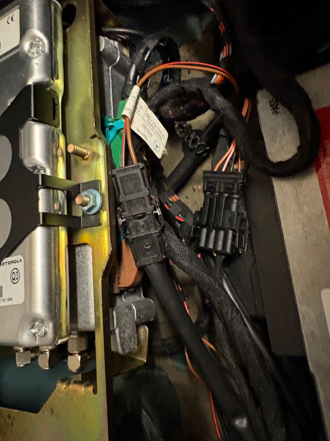

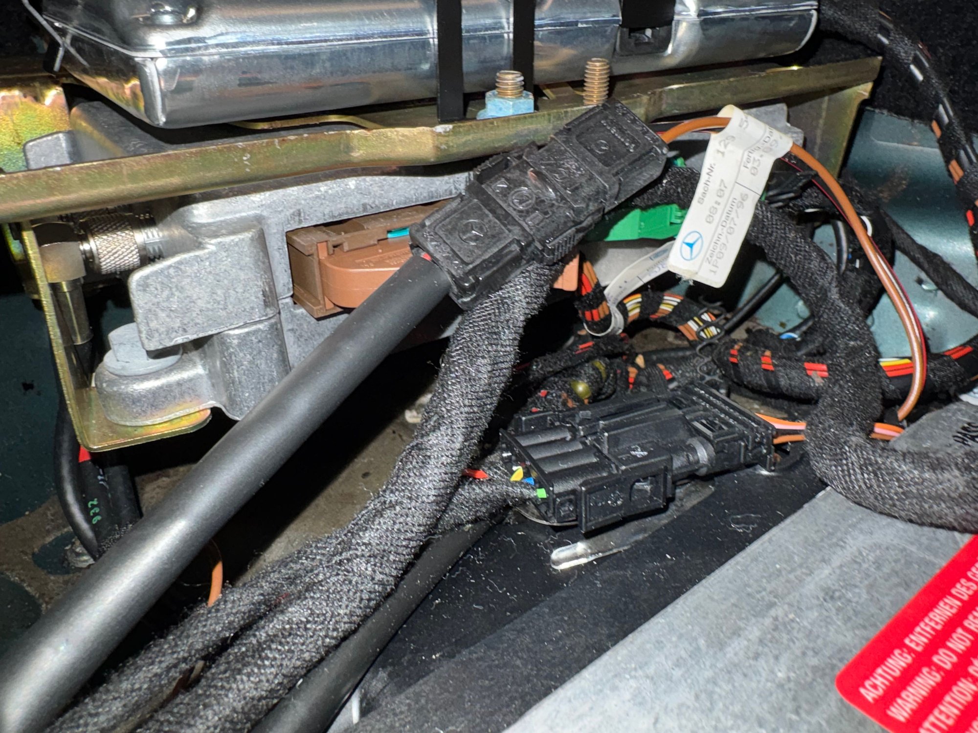

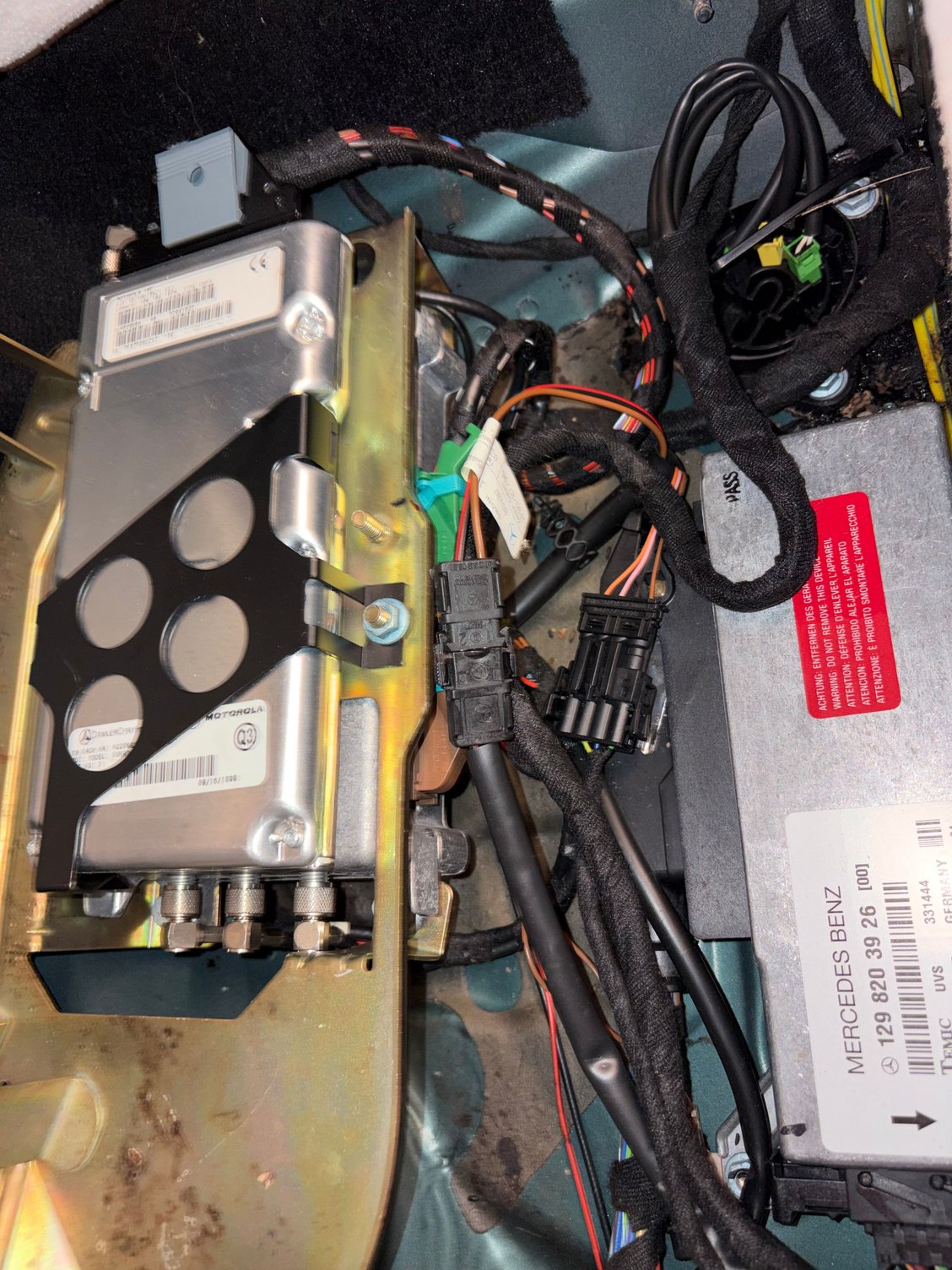

Finally got around to removing the cover plate to see what I’m working with… looks like just ‘top’ related modules to me. Anything related to the teleaid I should try and unplug? Nothing obvious to me in the pics…
Old Mar 2, 2026 | 01:43 PM
MCD157's Avatar
Joined: Jun 2022
Posts: 4
S212 E63
Looking at the pics more, it seems I have the following stacked on top of each other on the left side:Voice Control Bluetooth Module A2208200535
Voice Command Control Module 2208204726
Will unplugging them change any other functions in the car related to the stereo etc? Looks like a bunch of antennae and two multi-pin plugs on the command control module
