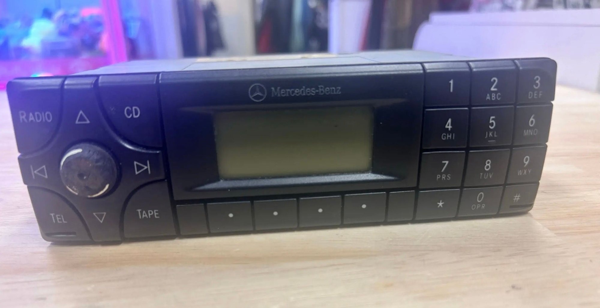

This is my radio.
to pick up the call I need to press TEL button (it changes audio source to Bluetooth). Then I’m picking up the call on my iPhone.
almost all the time I’m using BT anyway so it’s not a problem for me.

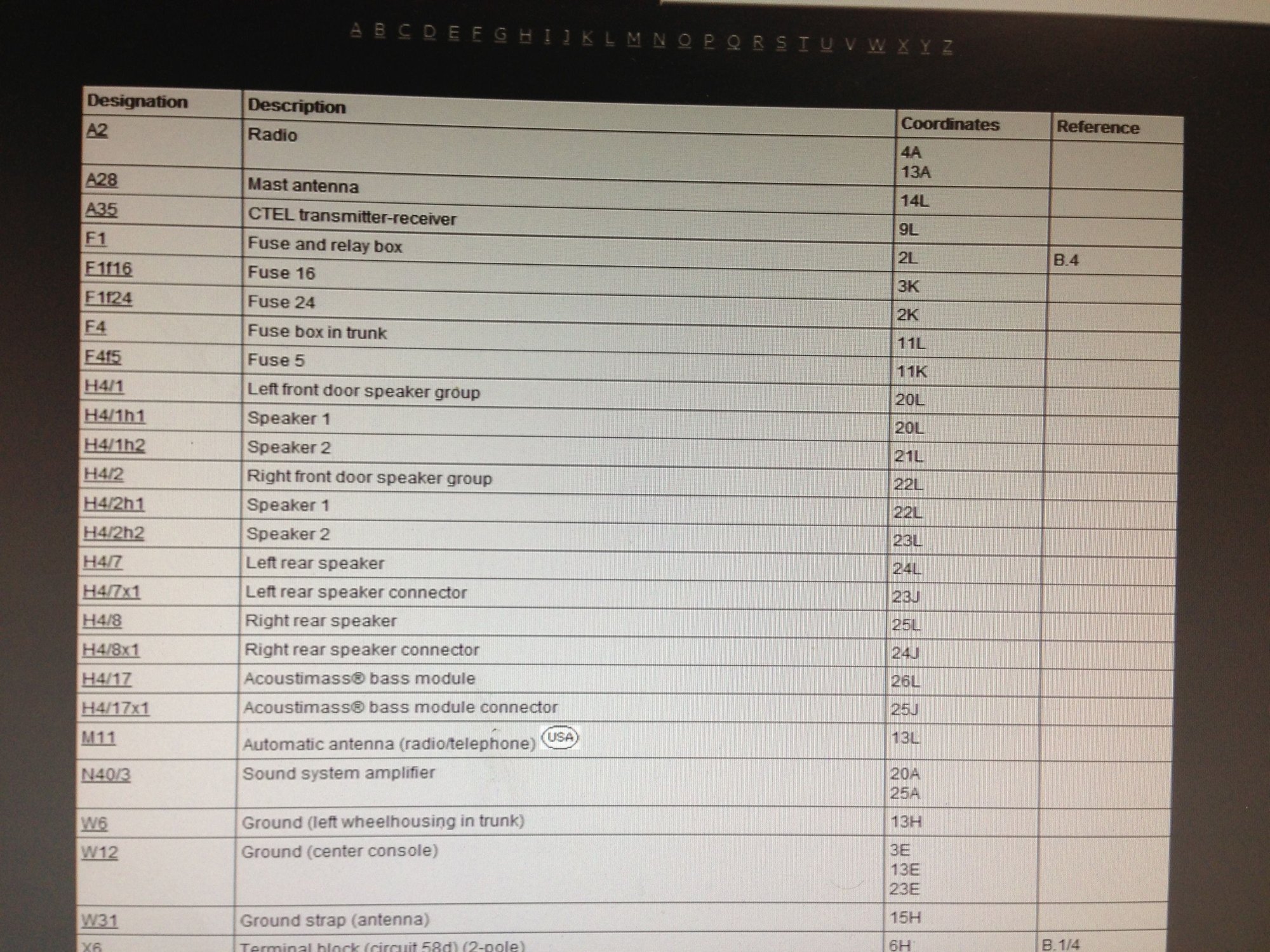

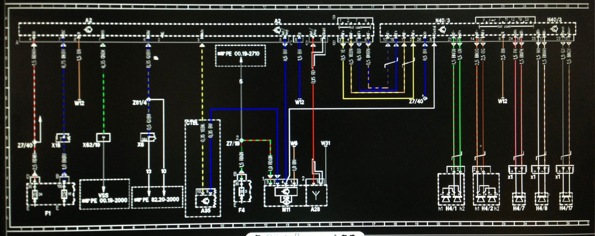

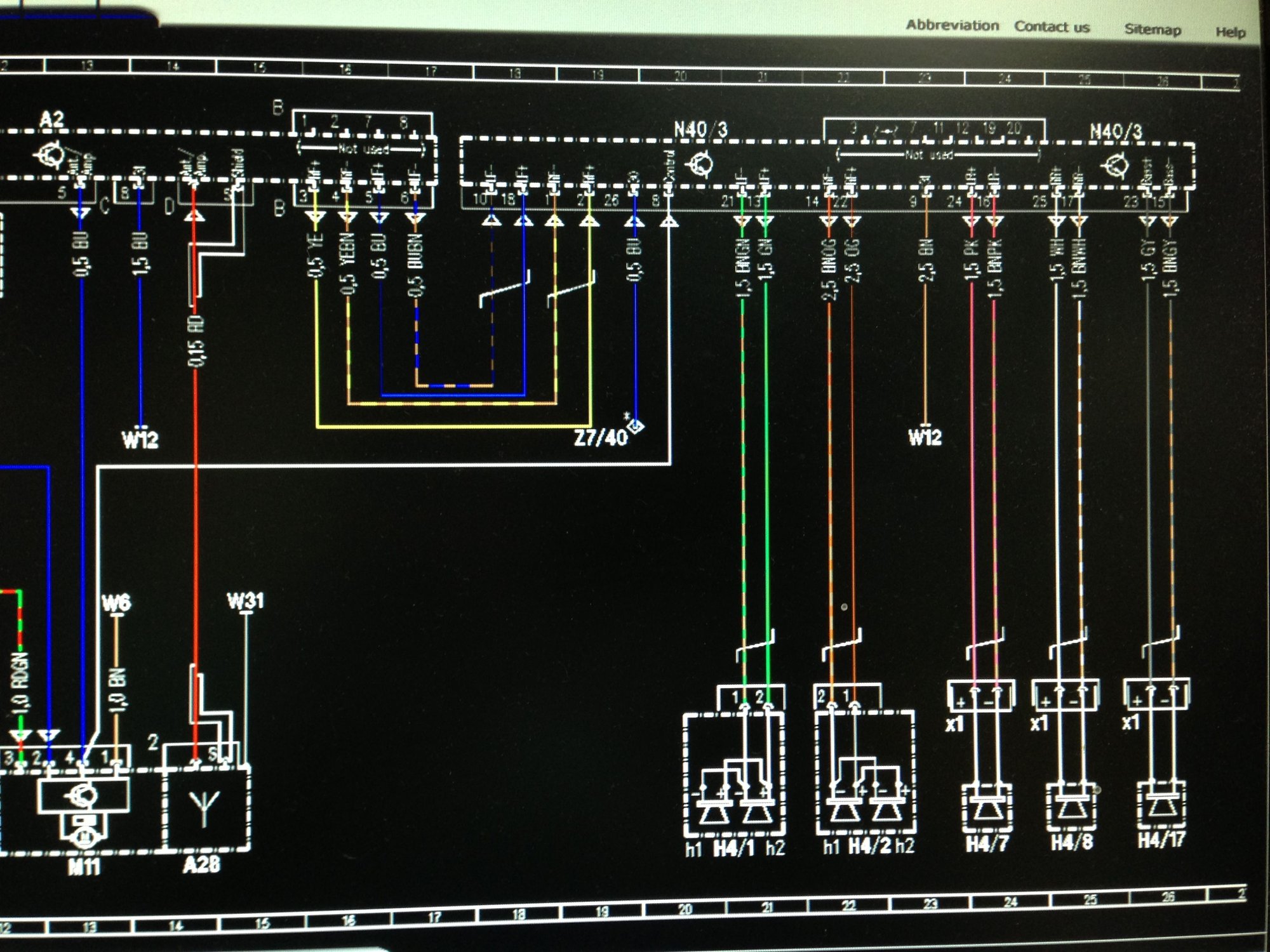

As for the BOSE amp and sub, YES it does go through the BOSE, sub amp and all. The Bose setup in our cars uses a speaker level input, not a line level input. That is why the EUROVOX works just fine as the factory fitted option we got here. It's a bog standard ISO connection with speaker outs. Any headunit will connect and use the BOSE amp and sub. I can post the wiring diagram if you like.

Sorry for the bad quality, I took these photos years ago from a screen on a very very old Laptop that I don't think would even turn on anymore😂
