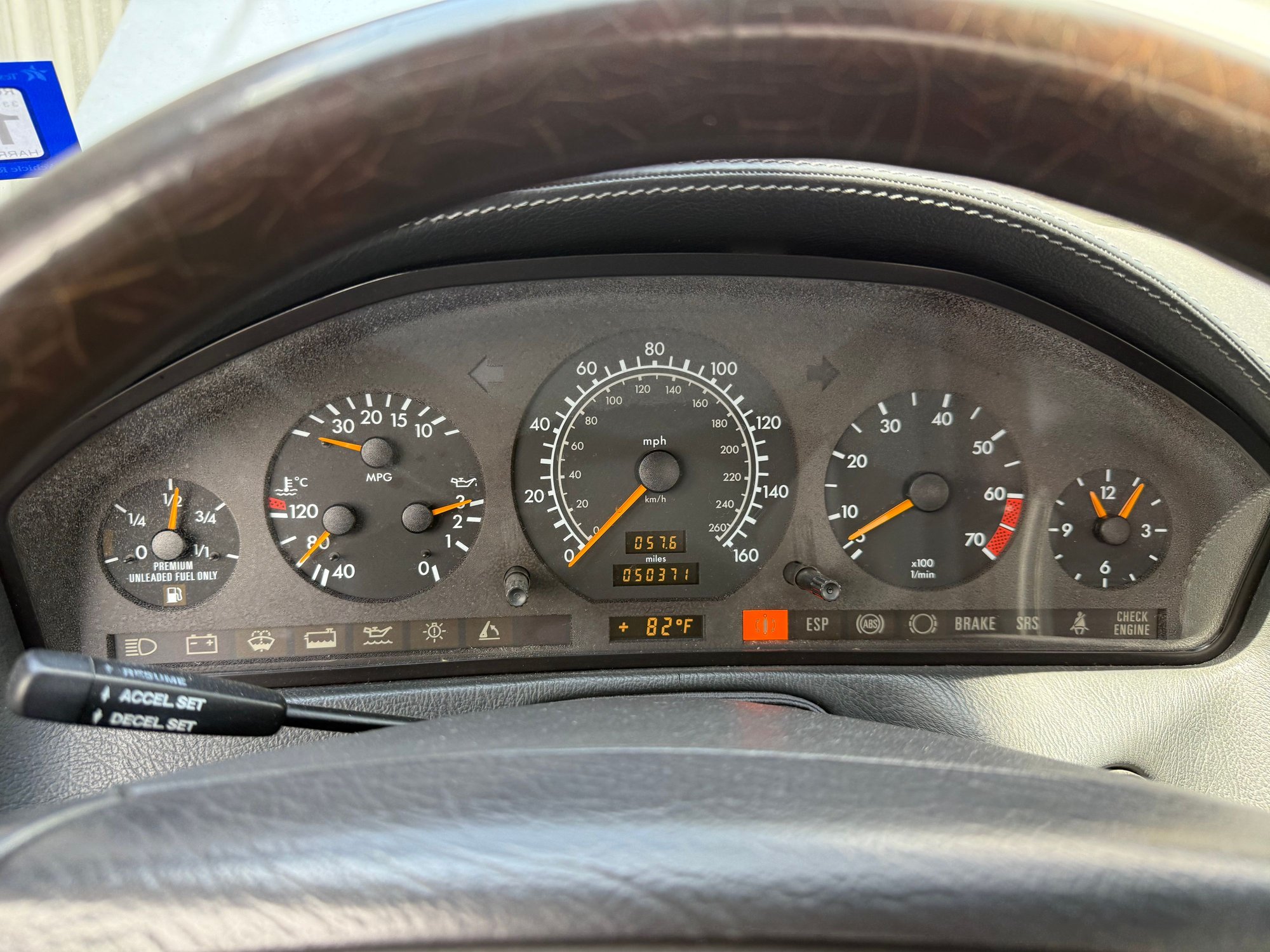

My SL600’s front suspension collapsed several weeks ago while driving. Initially the car wouldn’t raise at all. I had the caps in the ADS module tested, they were faulty and replaced. I reinstalled the ADS module and the car moves up and down very little. When I lock the ADS suspension, the ADS dash warning light turns on; it goes off when I unlock the ADS suspension. The front sway bar link that attaches to the height sensor was replaced with a new one. In my ownership, only the accumulators and fluid were replaced. Prior to this, ADS had been working perfectly.
STAR diagnosis gave me the following error after clearing and running the diagnostic test:
C1508
Level control blockings switch
S77/1s1.
I have tried searching for the switch part number with no success. I read a post from 2018 that stated the switch pins can lose contact.
Could this be as simple as swapping in a new switch or is there something else that needs fixing?

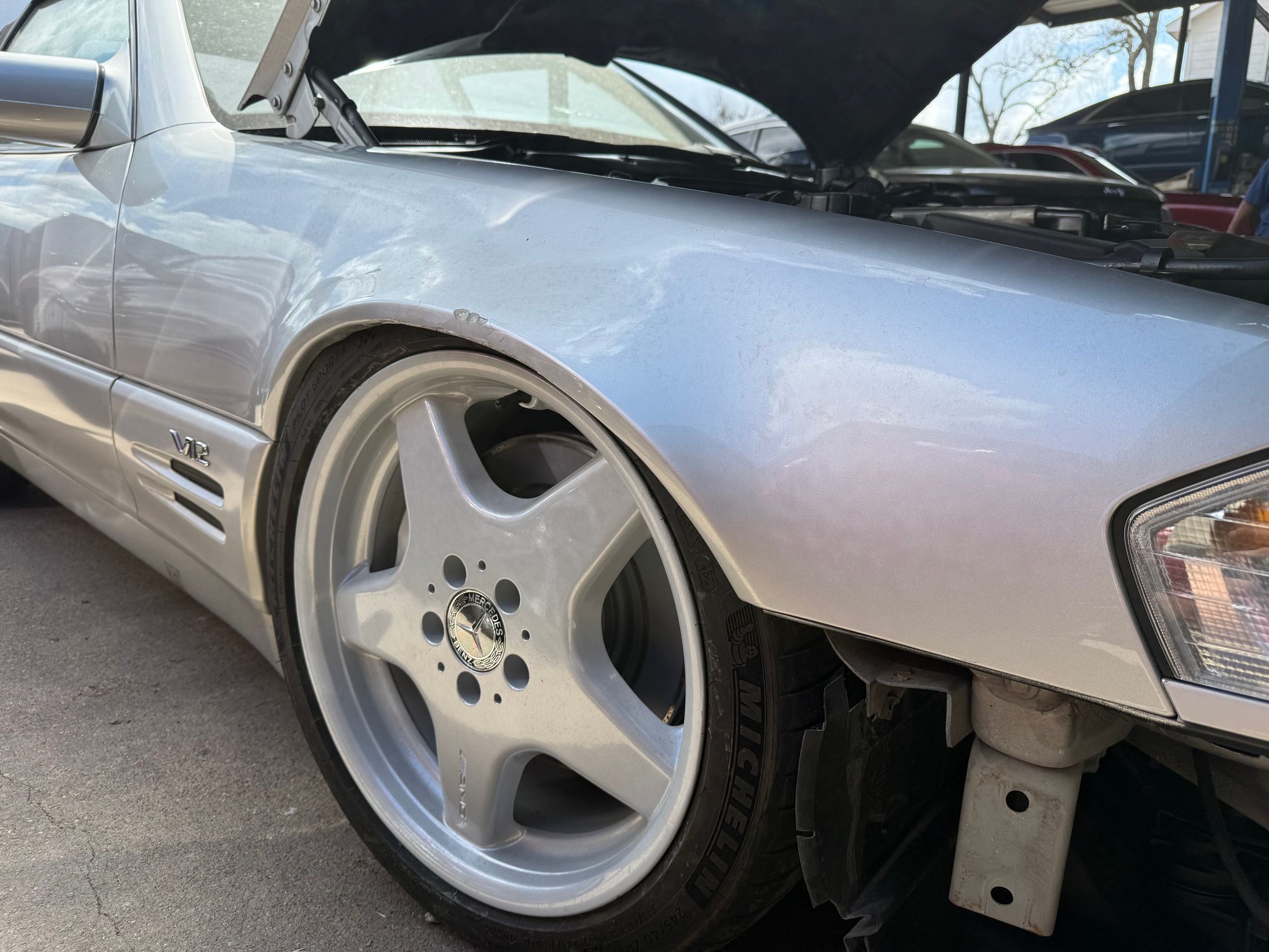

About 1 month ago, my father was driving the 600 when suddenly the car’s front end collapsed with damage to the fenders. He pulled over and the car eventually rose to normal height. This is what led me to suspect the capacitors were at fault.
The car was taken to the mechanic for repairs. The front sway bar linkage was among the parts replaced. After the car was lowered from the lift, the car collapsed while moving.

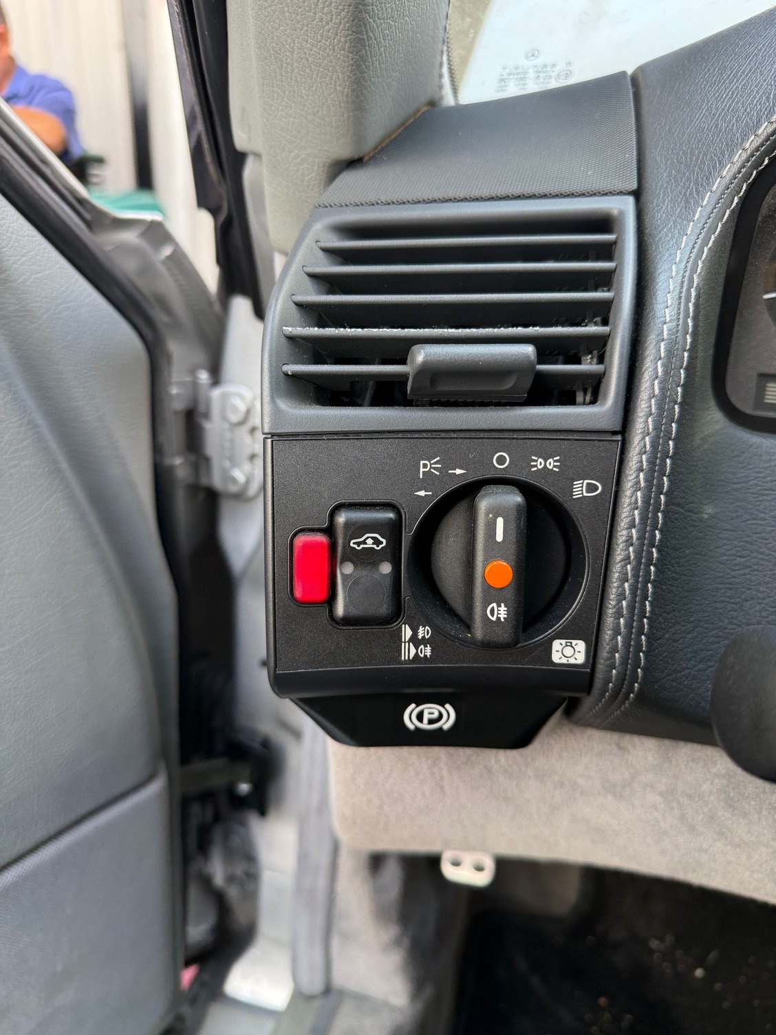

The error message is not an error; it always indicates when the red button has been pressed. A worn sway bar link is very common, especially after some decades of work. You have to adjust it manually after replacement, and you are right: Very tiny changes in lengh makes huge differents in hights.

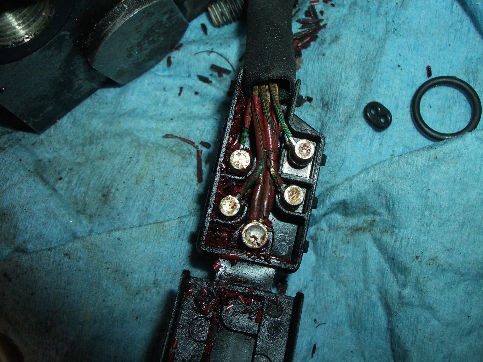

The ADS II valve block actuators wiring should be checked. It can be easily checked where the valve block harness plugs into the main harness near the bottom of the radiator reservoir tank.
Unplug it and pop it open, hope it doesn't look like mine did.
Easy to find and pop open.
If your plug looks like that, then there's no use looking at the actuator wiring itself.
I wonder if MB still sells the valve block?  I rebuilt mine with one I got in trade.

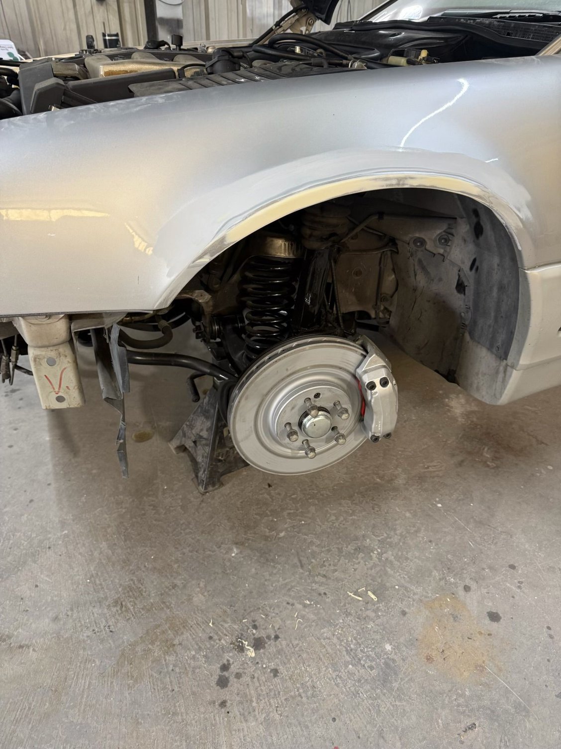

The car had new center link, tie rods, sway bar and idler arm bushings, 99+ control arm and brakes, and engine mounts (ouch) installed up front.

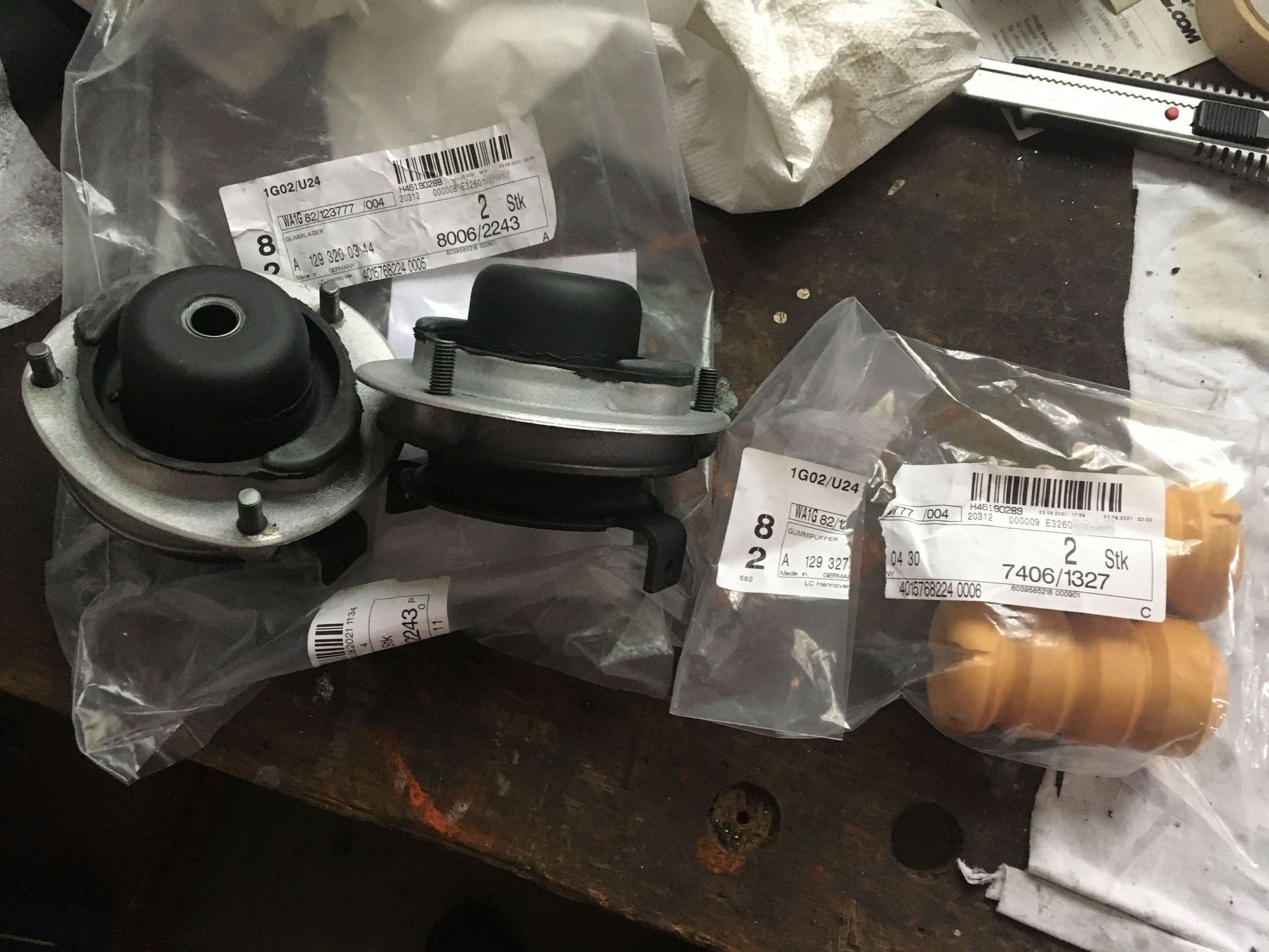

Also how would the front strut mounts be replaced.
Oil will leak out; the replacement is ZH-M. It's best to tighten the three nuts with the car on its wheels, not with the wheels hanging on a lift. Otherwise, the slight play in the engine mount bolts in the body holes can lead to the front axle being unadjustable.

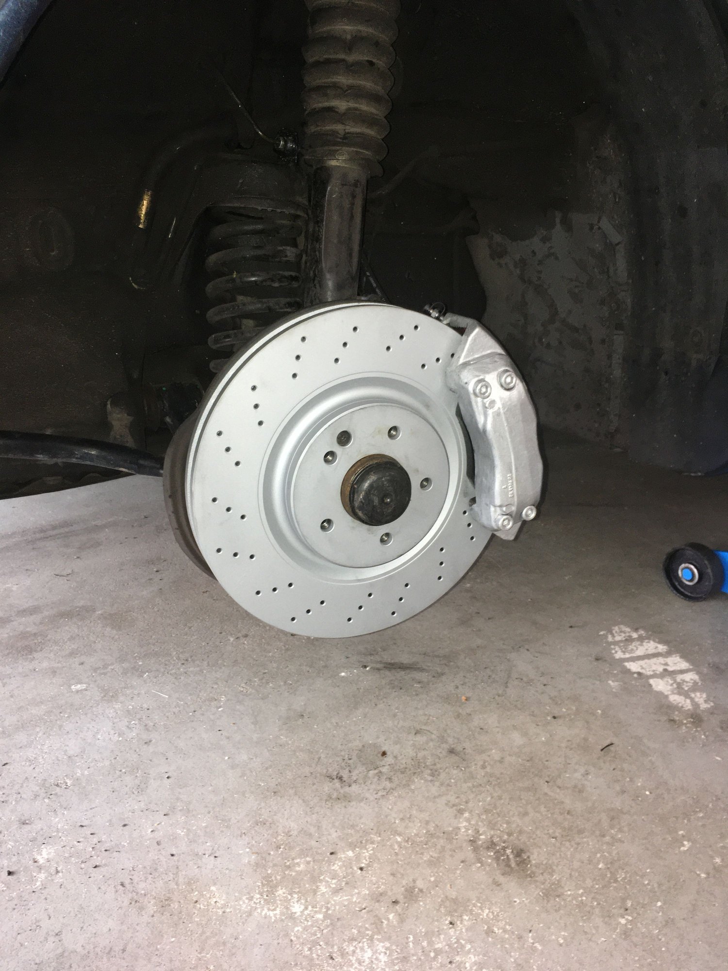

Thank you for the part numbers. I went ahead and ordered the strut mounts (ouch!). I was able to find a pair of 99+ brembo calipers for cheap. Had them rebuilt and painted silver. Now to fix the damage from those faulty caps.
