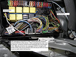

Hi All,
I am currently trying to find some information on process of removing the ecu from my 2005 /sl600 . can anyone point me in the right direction ? thanks

Hello....
I have done it this way...

thats great , thanks for your help. do i disconnect the batteries ?
Yes.... I took of the "minus" cable first... only to be sure no damage happens.

From Renntech:
http://www.renntechmercedes.com/www/...moval_R230.pdf

all done , thanks for all your replys.
