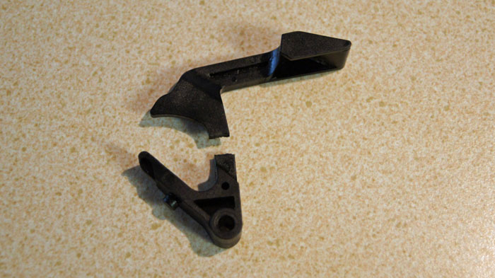

I decided as the cold weather rolls in to replace the park lockout pawl in the 04 SL600. Why do people wait until it breaks and leaves them stranded? Be proactive and replace it at your convenience instead of being stranded. It was fairly straight forward and will be a real peace of mind. When I took the original pawl off and put a slight pressure one it, it broke in two. Score one for the driver. You can get the good metal part at http://www.monoglobal.com.au

Which one from that site is correct for an 03 R230 (keyless go)? My stuck-in-park is being towed in tomorrow to the stealership where we'll find out how great the Mercury Platinum Extended Warranty is. I'd like to be proactive with 'fixing' the fresh shifter package they are likely to install.

GB3008 Gear Selector Lever W220/215/230
