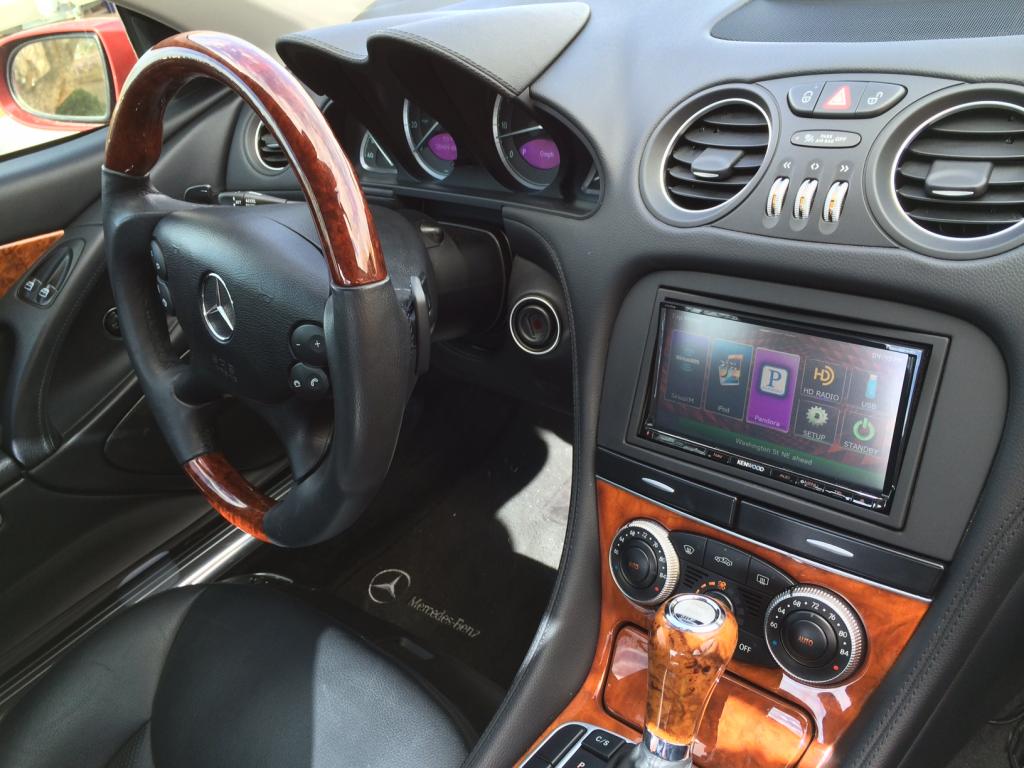

I put an aftermarket backup (and forward facing) camera on my SL550. Kenwood CMOS-310. I devices a custom mount near the trunk release switch. I then ran the cables through the trunk lid, down the trunk hinges (making allowance for the double-hinged opening here), under the trunk mat, through the firewall (biggest pain!), into the rear AGW area, under the center console, and up to the head unit. Phew. Took my about 4 hours of work, not easy. Now, it works great! I'm away from the car for a few days. Let me know if you'd like a picture of the camera mounts if that's what you're looking for.
