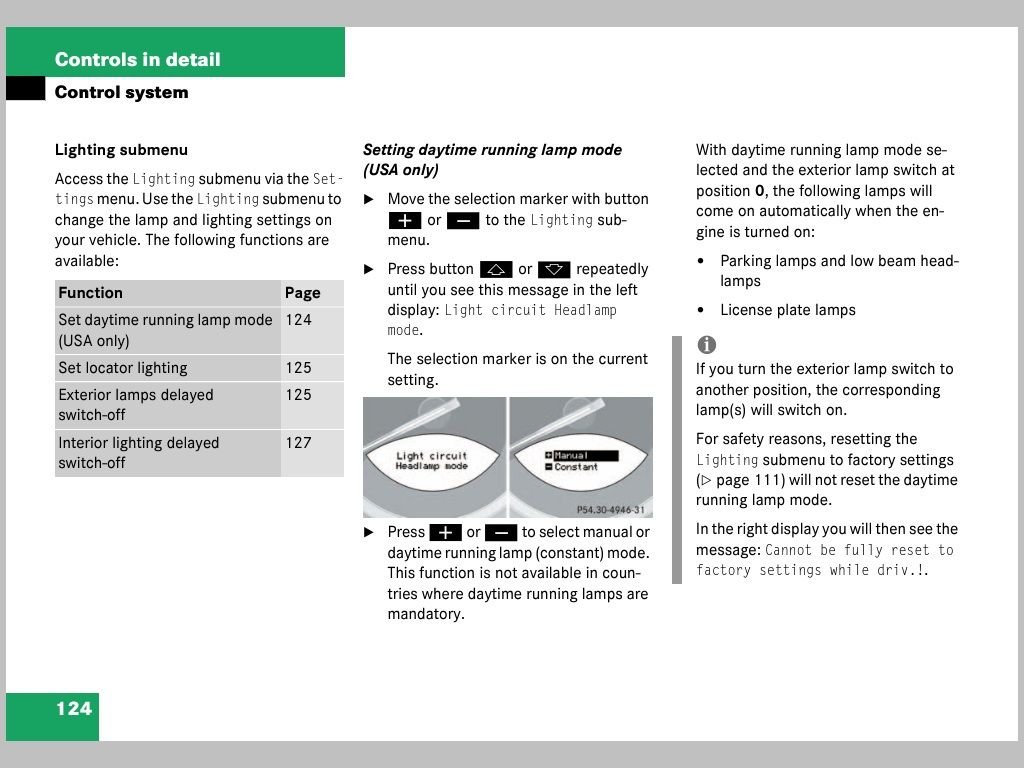

my 03 sl500 headlights stay on in the off position after I start it why?

Set on daytime running lights?

That would happen in the "Auto" position, not the "Off" position. That is how my DRL's are set up.

There is a user setting for "always on" that you can change .
