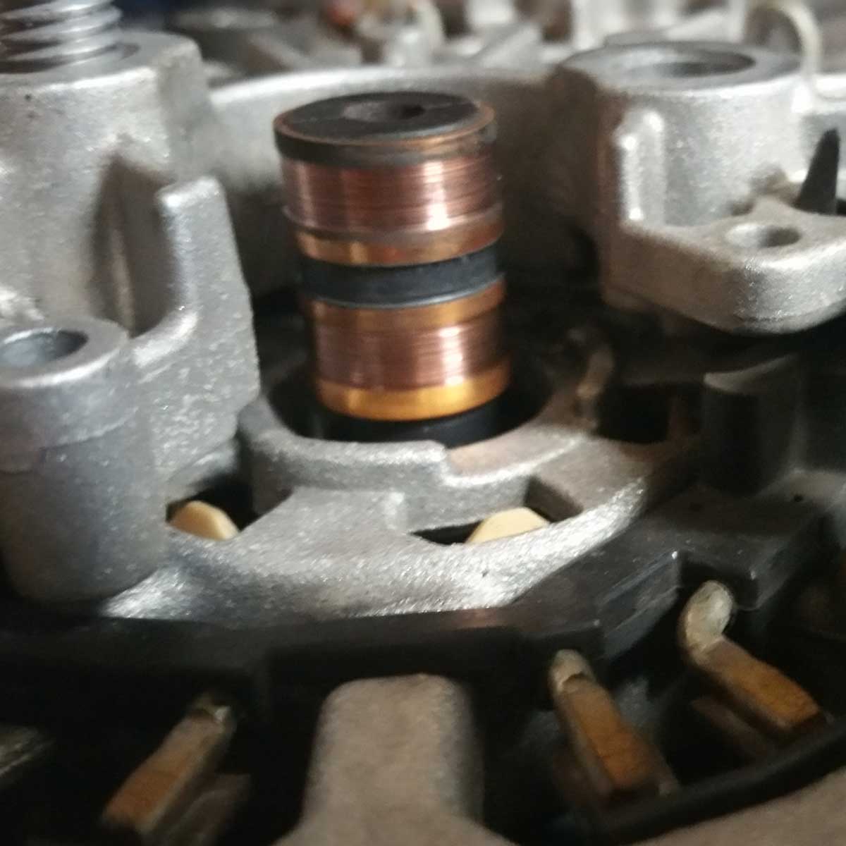

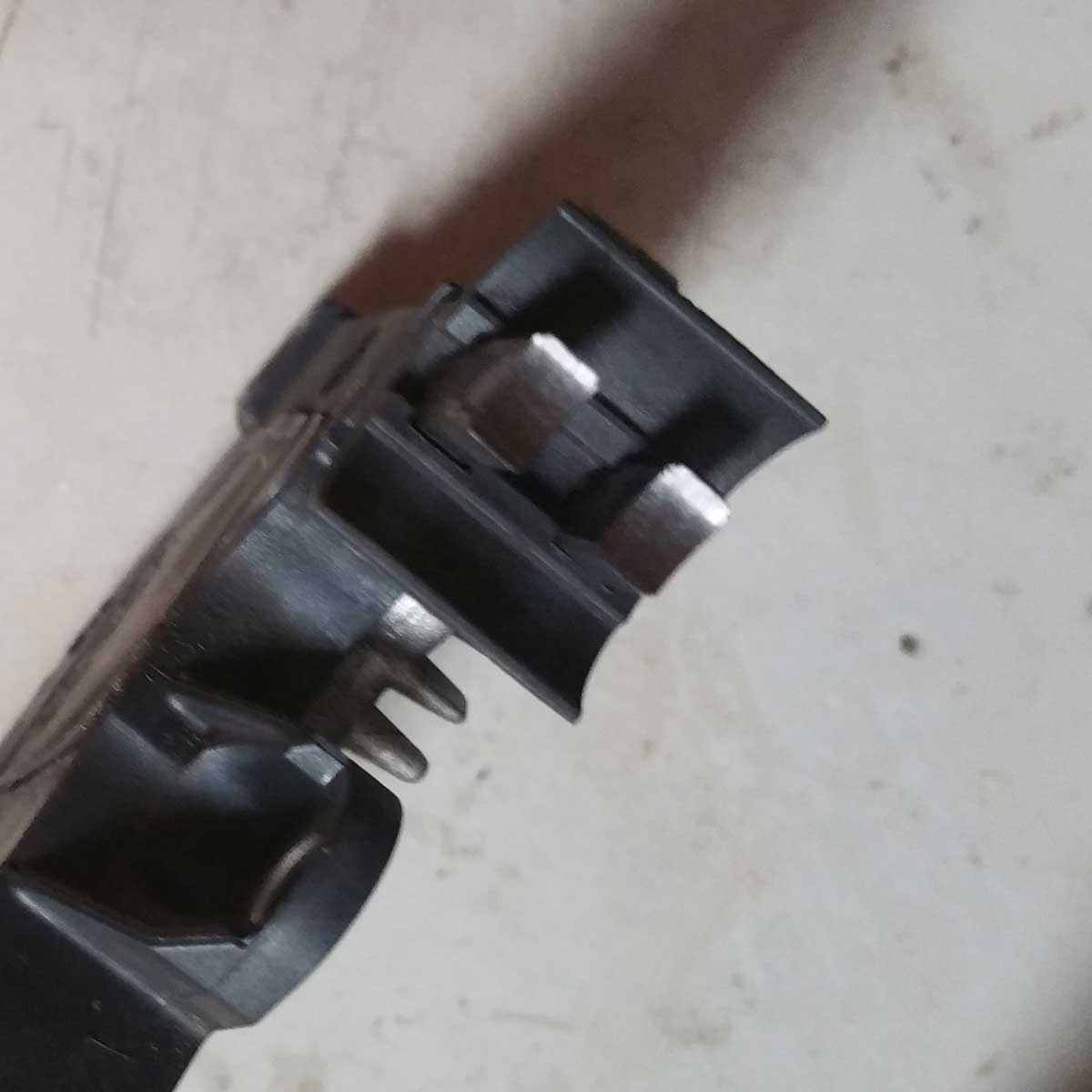

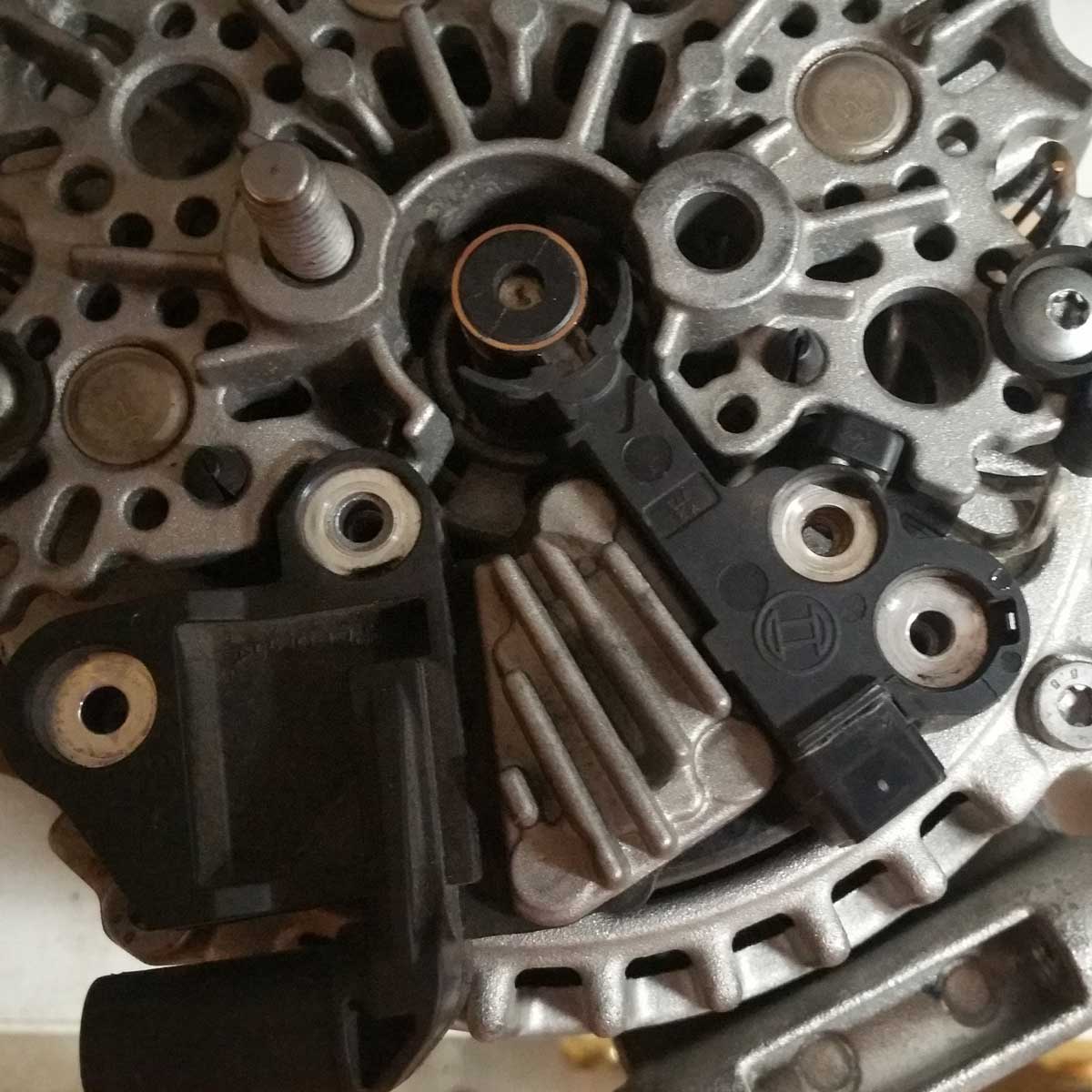

The regulator comes with brushes. Unless the alternator mechanically fails (bearings) it's usually just the regulator. In my case, the dealer charges almost as much for a regulator as Advance Auto charges for a lifetime warranted alternator (which includes the regulator). I didn't want to wait for delivery so I went with the $180 rebuilt one from AA. I did look at the old alternator. I see no problems with the brushes or rotor. I think mine was heat related because it would work in the morning, then die after everything was warmed up.
Here's the regulator on the alternator:
And the rotor:
And the brushes:

I had read somewhere that MB alternators were rather robust, but the voltage regulators could be a wear issue. So, $82. from FCP, and about 30 minutes working from underneath. It does take some finesse working in tight quarters, and I disconnected both batteries. The top regulator has the shorter, worn brushes.

I don't think the issue is the brushes. Even being shorter due to wear, they are plenty long. Look at my first pic - there is very little of the brush between the regulator and rotor. Those brushes could be worn much more and still make contact. I think he failure is in the electronics of the regulator.
