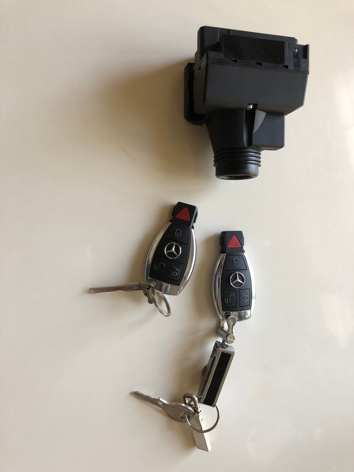

Well, I got the EIS out. It will not come out the side nor the bottom unless you remove the lower dash (not the lower closeout). I took out the cluster held on by 3 screws and pulled the switch out the top--super easy! The connectors and the bowden cable were the toughest part. I sent it out and will report back when I re-install it. BTW I did find out the the dealer in Scottsdale will order the fob pre-programmed but requires roadside assistance to come out to make sure it works--go figure! Total cost was going to be $340 for the fob plus $80 for roadside assistance. It would have been cheaper to have the car towed for free. All in all I will spend $200 and some minor work. I guess there are too many snobs around here to drive the prices up and discourage do-it-your-selfers.

I got my ignition switch back together with 2 new Fobs and emergency keys already cut. It took me 10 minutes to pop it back in through the cluster opening and bingo--it works just fine. Bottom line is it cost me $200 per fob and a week down time. The Fobs are the new style and appear to be genuine Mercedes parts
