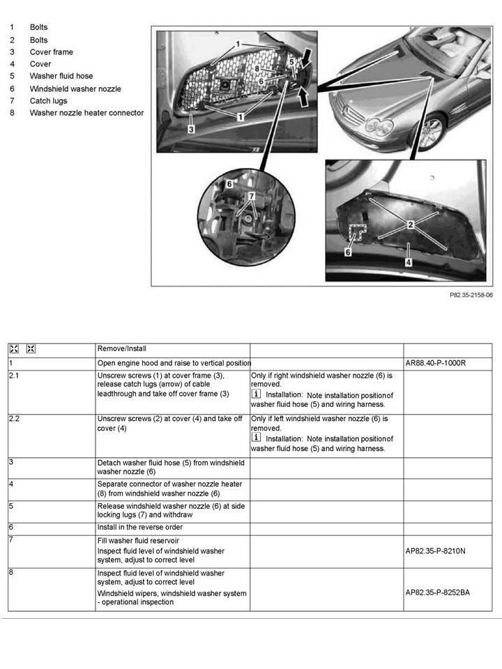

For an '07 SL550. The box under the decorative hood fins (example here:
Amazon Amazon
) has some leaves and other stuff in it. Can anyone advise me of a safe way to gain access so I can vacuum it? Thanks.

Here's the procedure:
