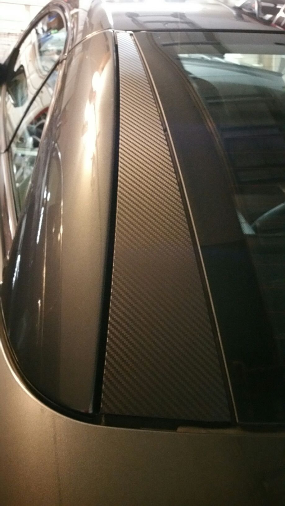

Are you talking about the shiny black plastic trim between the painted C-pillar and the glass? That plastic trim commonly degrades when exposed to the elements. You can buy new ones (under $100 each) and they are not very hard to replace:
http://benzbits.com/R230/C-PillarTrim.pdf
Another option is to cover them with vinyl. I did this with 3M Dinac faux carbon fiber wrap:

Thanks Rodney!
I have the same issue and was going to have a body shop paint them but for the same price, I'll replace the trim pieces.
