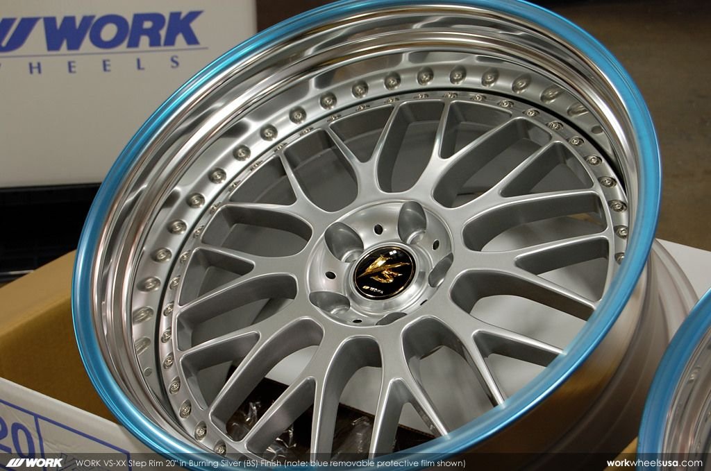

Yes i like quite a big "lip" on the wheels i have on my cars so i would go for something like on the pictures below. Not chrome polished wheels but silver and i might go for gold or copper center
I would have to check how wide i can get the lip before ordering any wheels :-)
As Ghostty said if the difference between 285 and 305 is only 20mm is not much at all so i cant see any problems having 305 or even wider tires fit
A bit lip on this wheel
Like this rim
More lip than what is on this Japan Racing whel

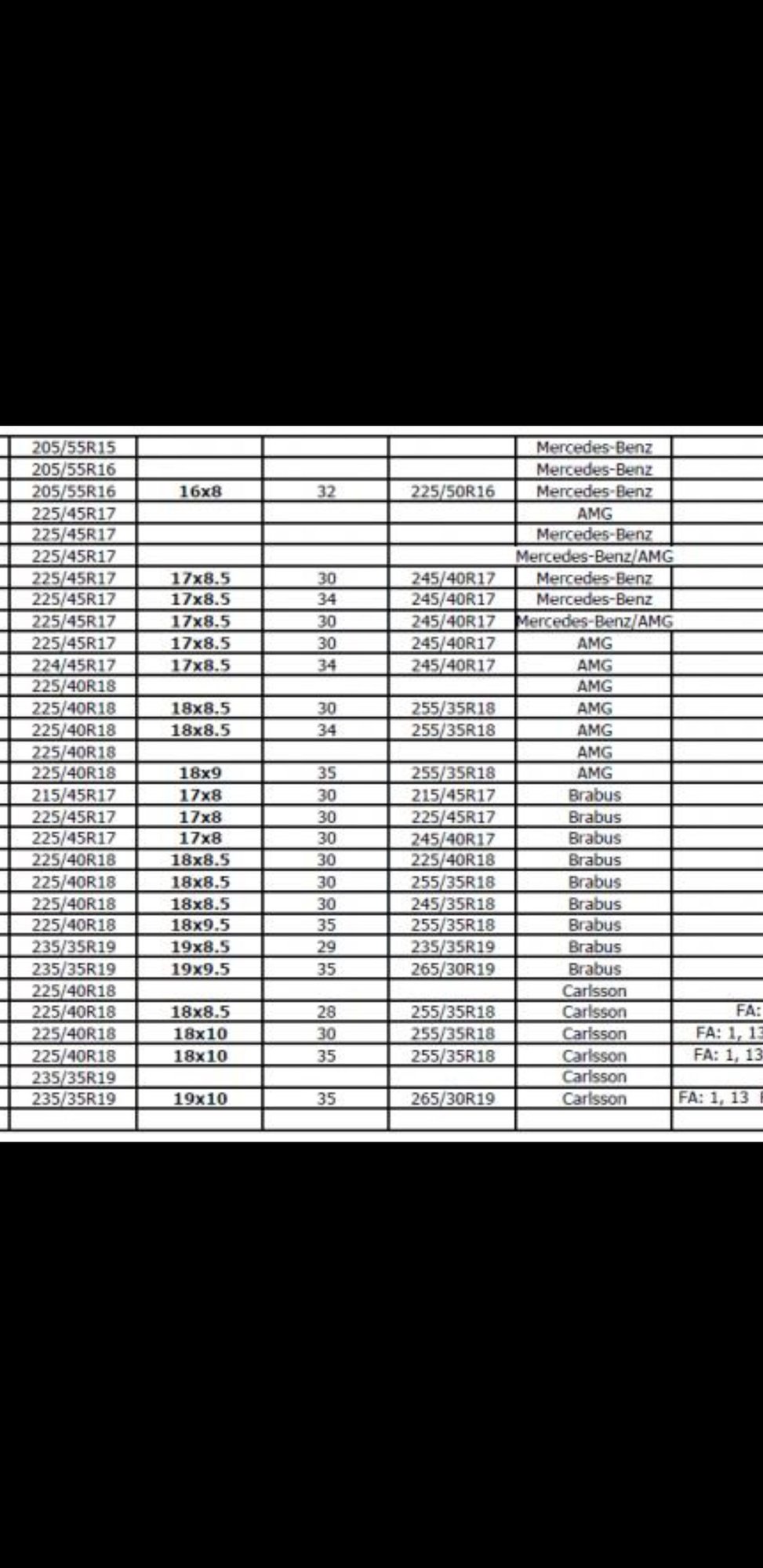

2005 SL500, 2015 CLS400
35mm was measured by MB and for 10J width was not considered as unfit. That means it won't touch or bump into anything from the suspension or body.
See attached.
P.S.
10.5J will still fit without problem
Old Apr 4, 2018 | 12:58 PM
