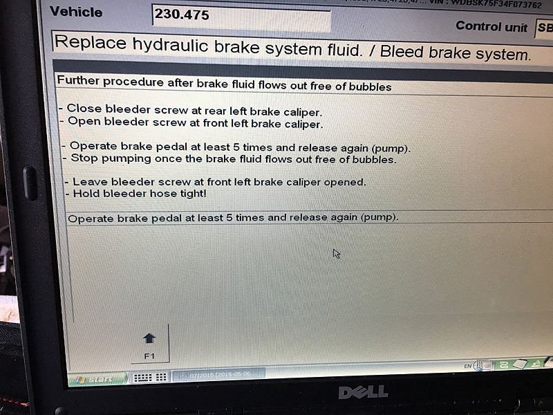

SDS brake bleeding fail
I went thru the SDS brake bleeding procedure and ran into a snag when starting the front brakes. After doing the rear brakes this page starts the front brake section and there is no "continue" F3 button. There is only the F1 button which takes you back a page and asks you if you want to redo the wheel.
What's up with that? Anyone else do this and have a problem here? Maybe I have a bogus program.

Doesn’t look like the sds was done with the 5x pump. Might try going 1 step back, go next, (to where it’s asking you to pump 5x) and it should either confirm pressure and prompt you on or give you an error code explaining what it is

Yes, that is a good point as I did not do the 5 pumps. Previous steps always had an F3 or continue button visible that you hit when you are finished with the step or want to start the step. Maybe in this step you only see the continue button once you've finished the 5 pumps....hmmm. I'll get some more fluid and try it again.

Tried it again yesterday. After stepping on the brake pedal 5 times, the "F3" continue button pops up.
Brake's are much improved after doing this routine. Not near as much force needed on the brake pedal to
stop the car.
