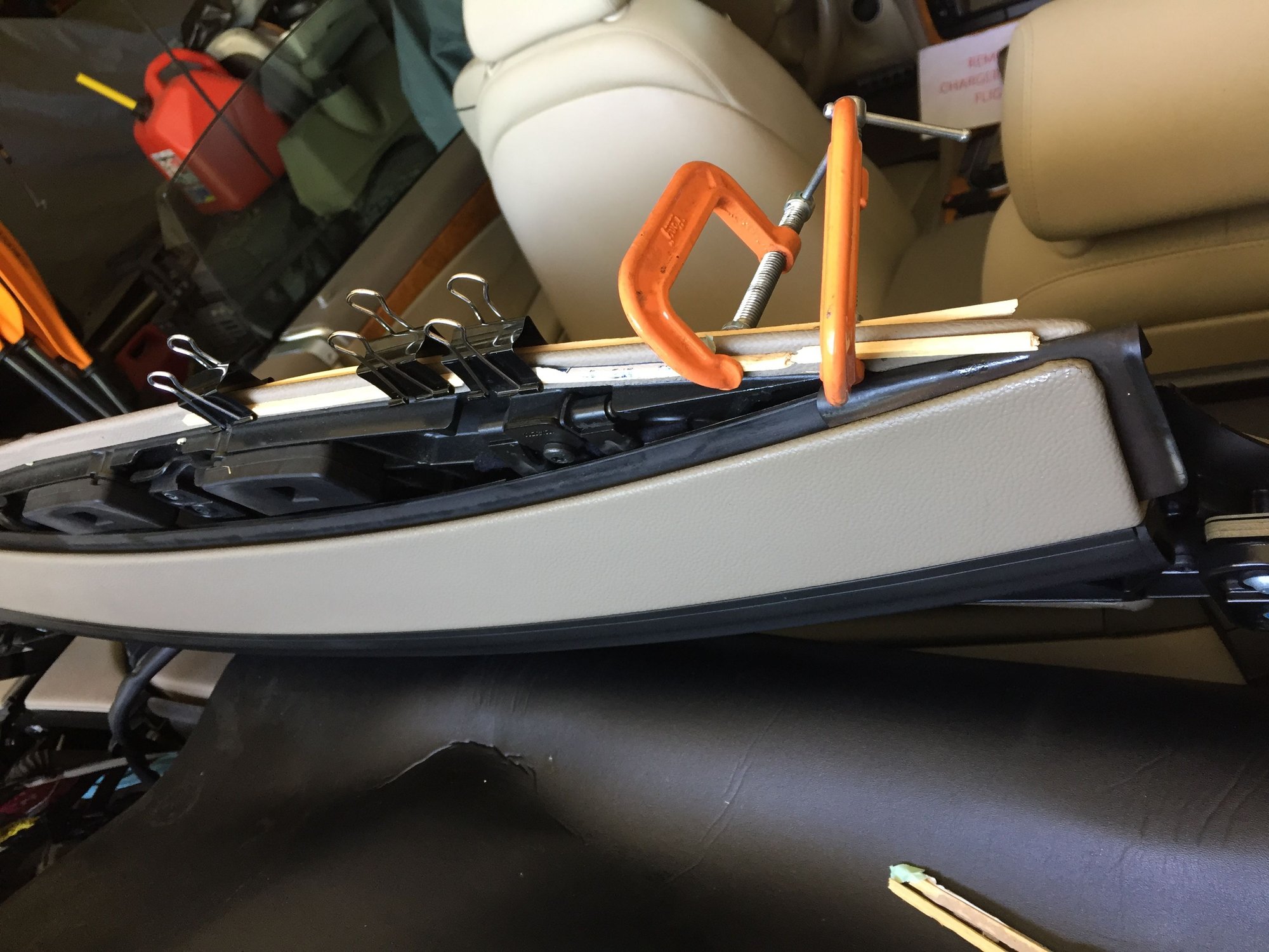

the leather covering the rear deck package tray had separated from the frame. A bit of adhesive, fowls and clamps......fixed!

What adhesive did you use?

Gel style super glue. The thicker type sticks to the surfaces without running.
