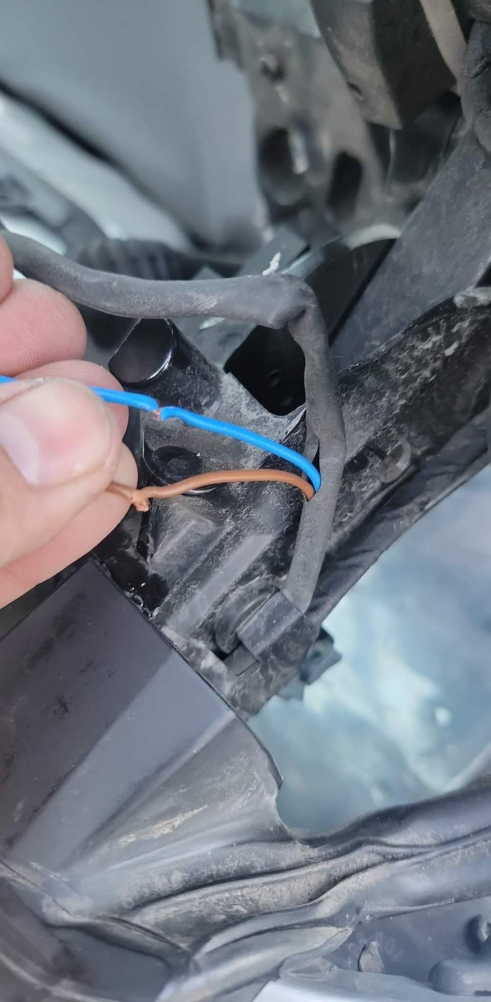

Originally Posted by Frederick NL
I don't think that has anything to do with the SmartTop unit. I would suggest to re-read this thread and do the checks.
thanks again for your help . The car definitely doesnt have the smart roof option . Ive reread the thread numerous times lol . And seems like i get stuck in the same position. Sequence starts as normal . Roof unlocks trunk moves back in position. Windows do not go down and flaps donot open. Pump keeps running but nothing else happens. I am able to open the glaps if i jump the wires directly on the flap motor . No codes when scanning the vario roof 😢

Read post #18, what is the status of the switches? If your scanner isn't capable of reading those switches, get a different scanner.
thanks for your help finally foun
d the issue. The wiring coming from the lock/unlock switches were stripped tight where the roof folded. So the switches wouldnt code malfunction . But when starting to close the roof the 2 wires would touch changing the status of the switch to locked .
