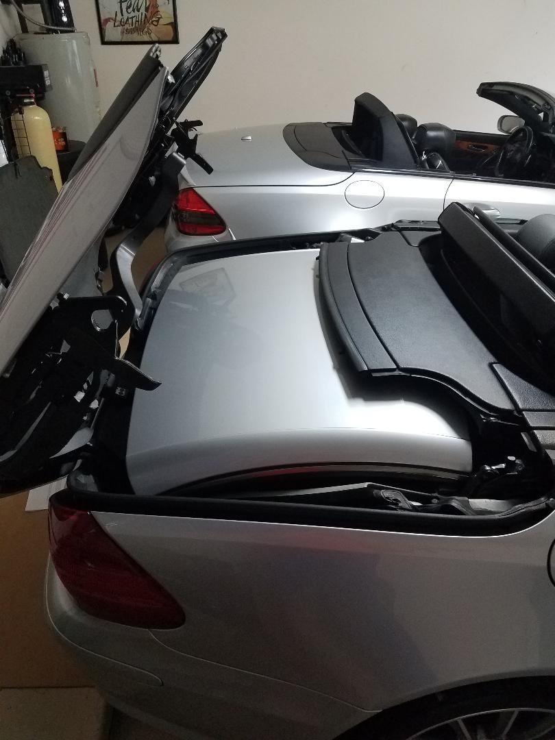

Uh oh. So that helped some ...
So, I went to "close" the roof, after semi-matching the fluid level in my OTHER R230, with the roof down, and now ... I am stuck in an even worse situation. crap. crap. crap. Ha. So, I can't access the pump now now, what I beleive is the manual way of "emergency closing it".
My current situation with my lid ....

Here's the manual close instructions:
http://benzbits.com/r230/roof/ManualClose.pdf
And for the flaps:
http://benzbits.com/r230/roof/ManualCloseFlaps.pdf
I'll bet you front lock cylinder (in the roof) is leaking. You'll probably find all the fluid you added in the last few days in the roof panel.
