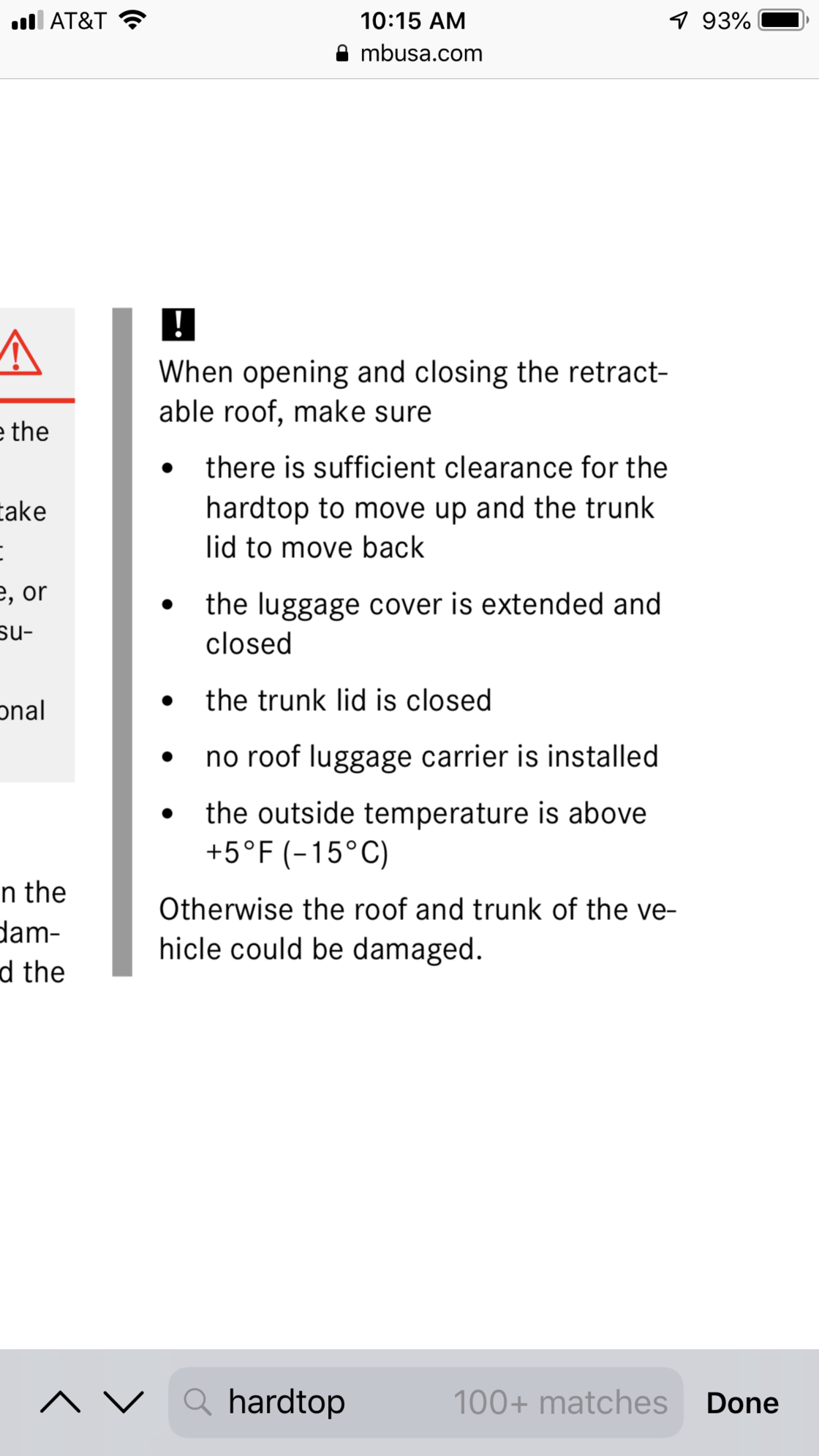

Looking at an ‘04 SL500. Had a hardtop issue that was recently repaired. Repair shop tells me it was just a loose electrical connection.
Seller says MB recommends not operating top below 40 degrees (it’s currently 8-brrr!). I can’t find any doc that says not to operate the top - is that a thing?
Will probably wait til it’s warm enough to see the top in action, but just wanted the group’s reaction. Thanks!

Well, that was a rookie question. Google was little help, but I did find an owners manual and it says 5 degrees. Beautiful weather for top-down motoring. It’s up to a balmy 15, so I should be good to go...

I am guessing the primary reason that the manual states not to operate the top below 5F is because of the possibility of ice that could interfere with its movements. The manual also states that the roll bar should be manually raised when driving in outside temps below 5F. That sounds more like a concern about operating the hydraulic system in very cold conditions. However, there is no caution about operating the trunk lid (for cars equipped with the hydraulic open/close feature) in cold weather. So maybe that is just an oversight on the trunk, or maybe it has nothing to do with the hydraulic system.

Add to it that car is equipped with windshield washing tank heater and wiper heaters, so it is designed for really cold conditions.
