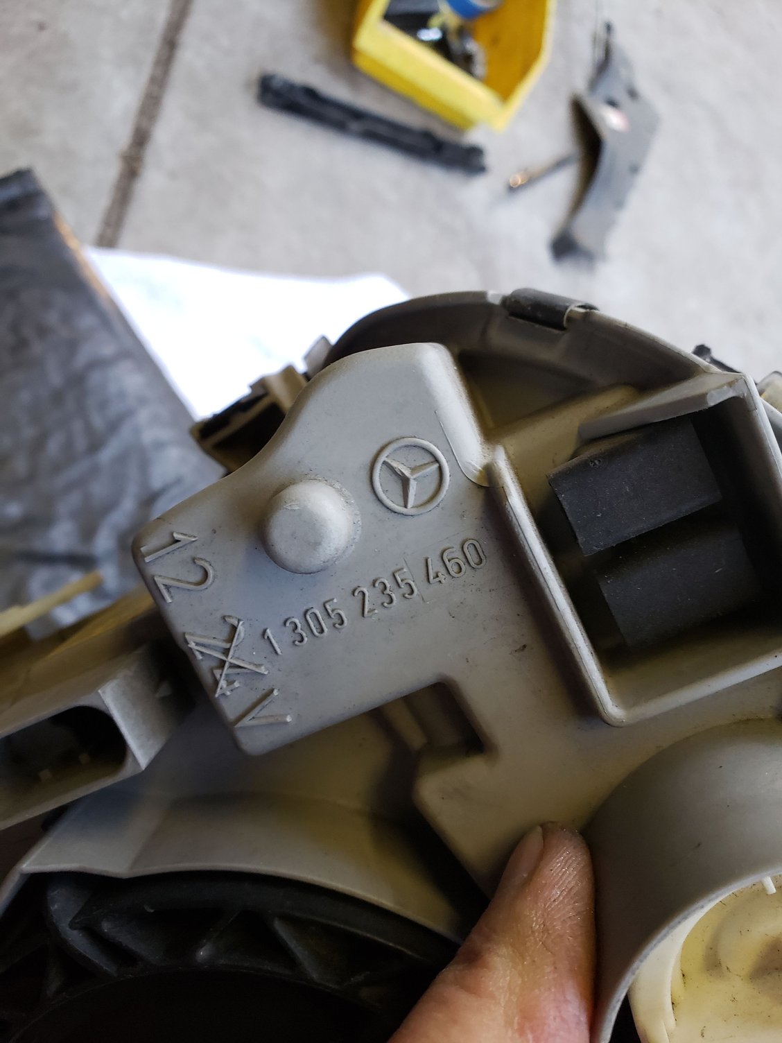

looking into this further, I found that it was consistently listed as being for 2005-2012 R230 ..... in fact, one seller's search tool ... at amazon, ebay or an official MBZ site even popped up with the message that it was NOT compatible with my car after I filled in the fields. But I decided to look a little deeper and found a picture of a headlight that was using the kit that had the same cast-in number as I found on the rear of my headlight (shown in one of the pics attached). Not saying that it will work on all 2003/2004, but it works on my 2003 (so you may want to compare your cast-in number if you have a 2003-2004.

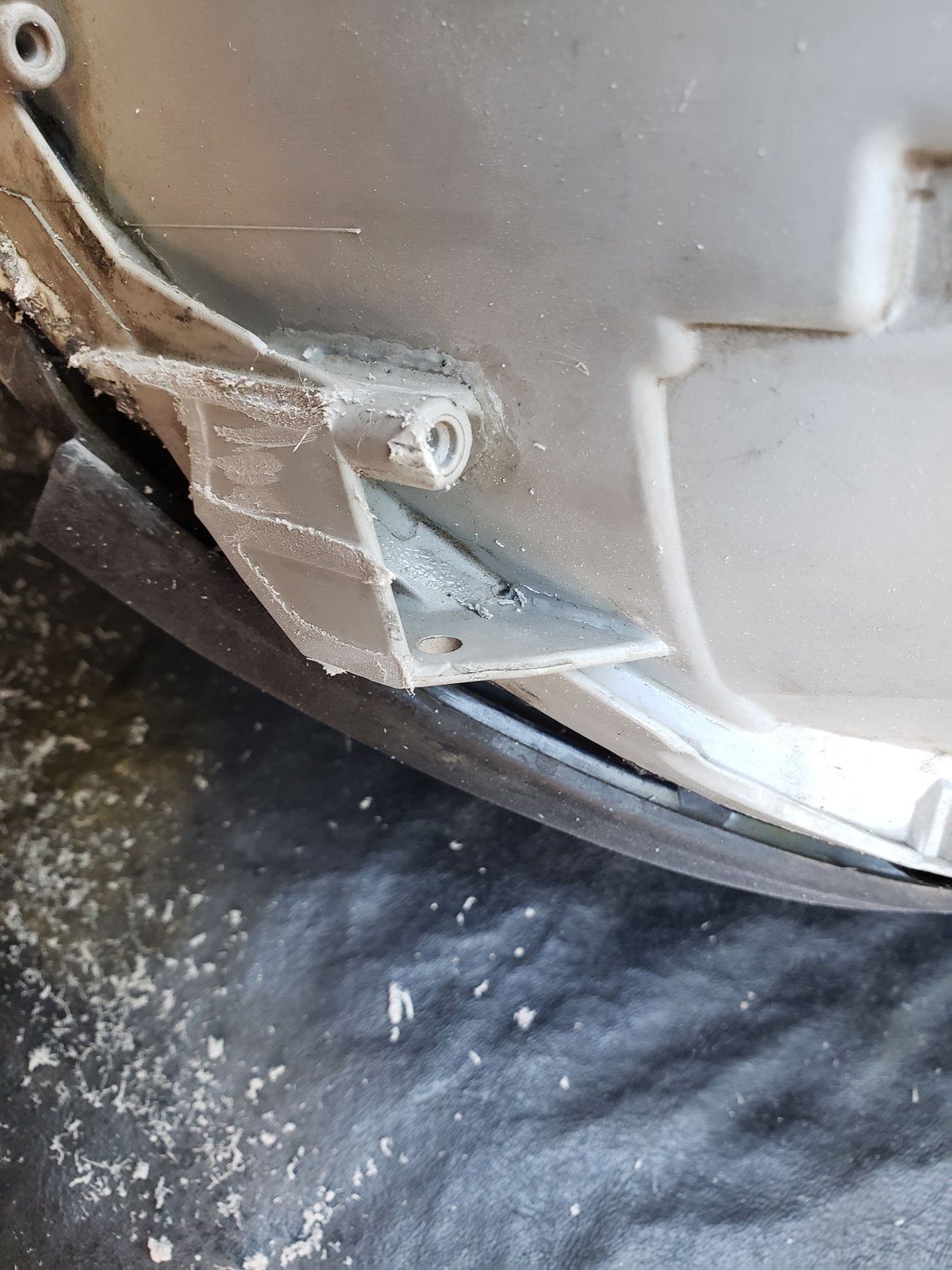

Installation was easy enough. the headlight NEEDS to come out of the car which requires the bumper be removed (or at least un-fastened on the side you are working on). The kit comes with a replacement for the upper and inner tabs and the 6 screws to secure them and some weak instructions that suggest you refer to an illustration that does not seem to exist (so you can look at my photos and get the clarification you might need) . You do need to trim the broken tabs off (use the replacements as a guide for where that trimming should take place. There is room to repair the headlight at the point where it become the gusseting for the original tab(s), so you may want to repair any cracks to make your finished project as bullet proof as possible.

This is the number that is cast-in the back of my 2003 headlight that led me to believe the kit would work for me ... and it did

headlight manufacturer cast-in the screw hols for the repair parts. This tab broke off taking half of the vertical screw hole, so I cut off part of the broken tab and glued it on BEFORE installing the repair part.
