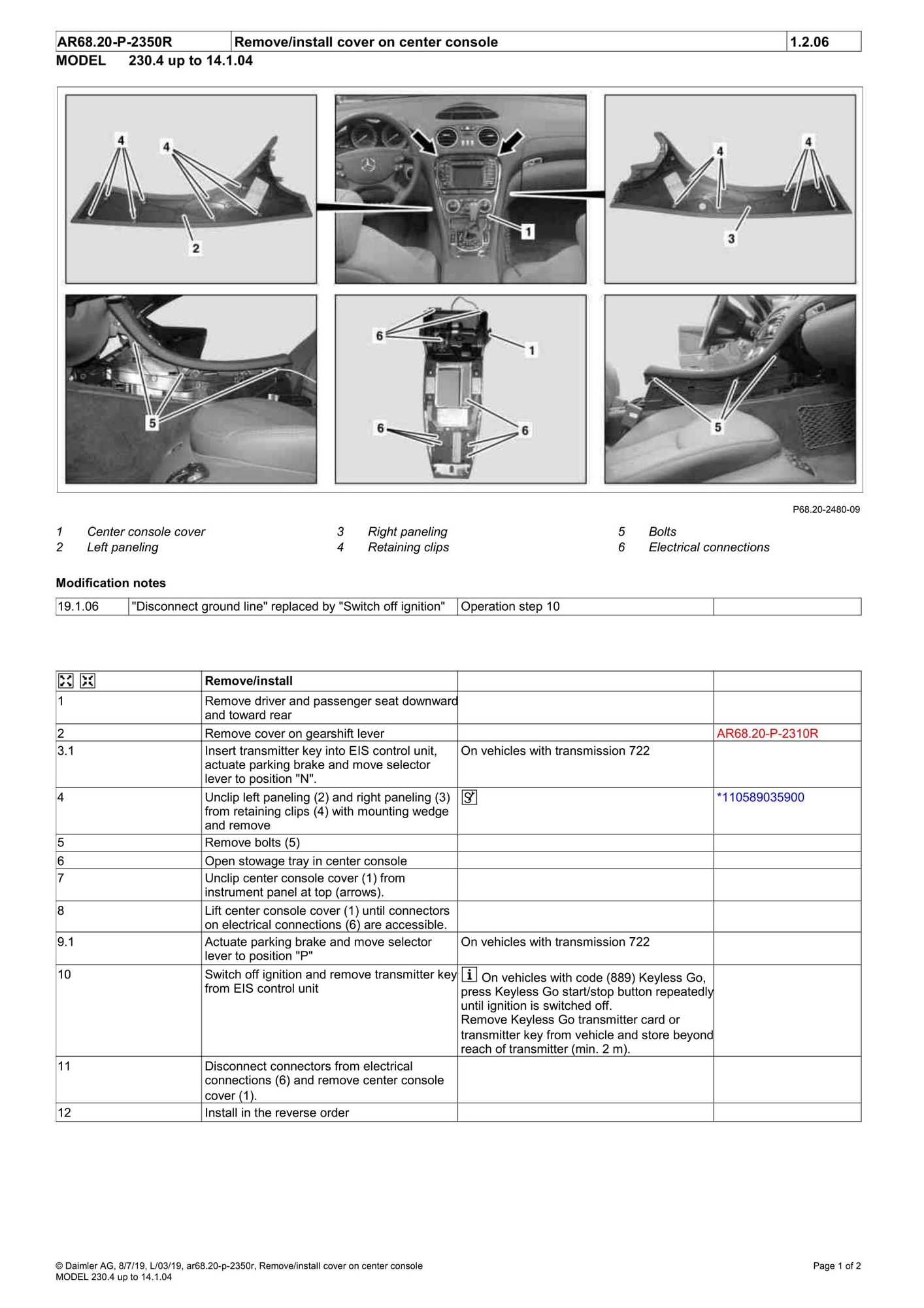

See if this helps:
http://benzbits.com/r230/CenterConsole.pdf

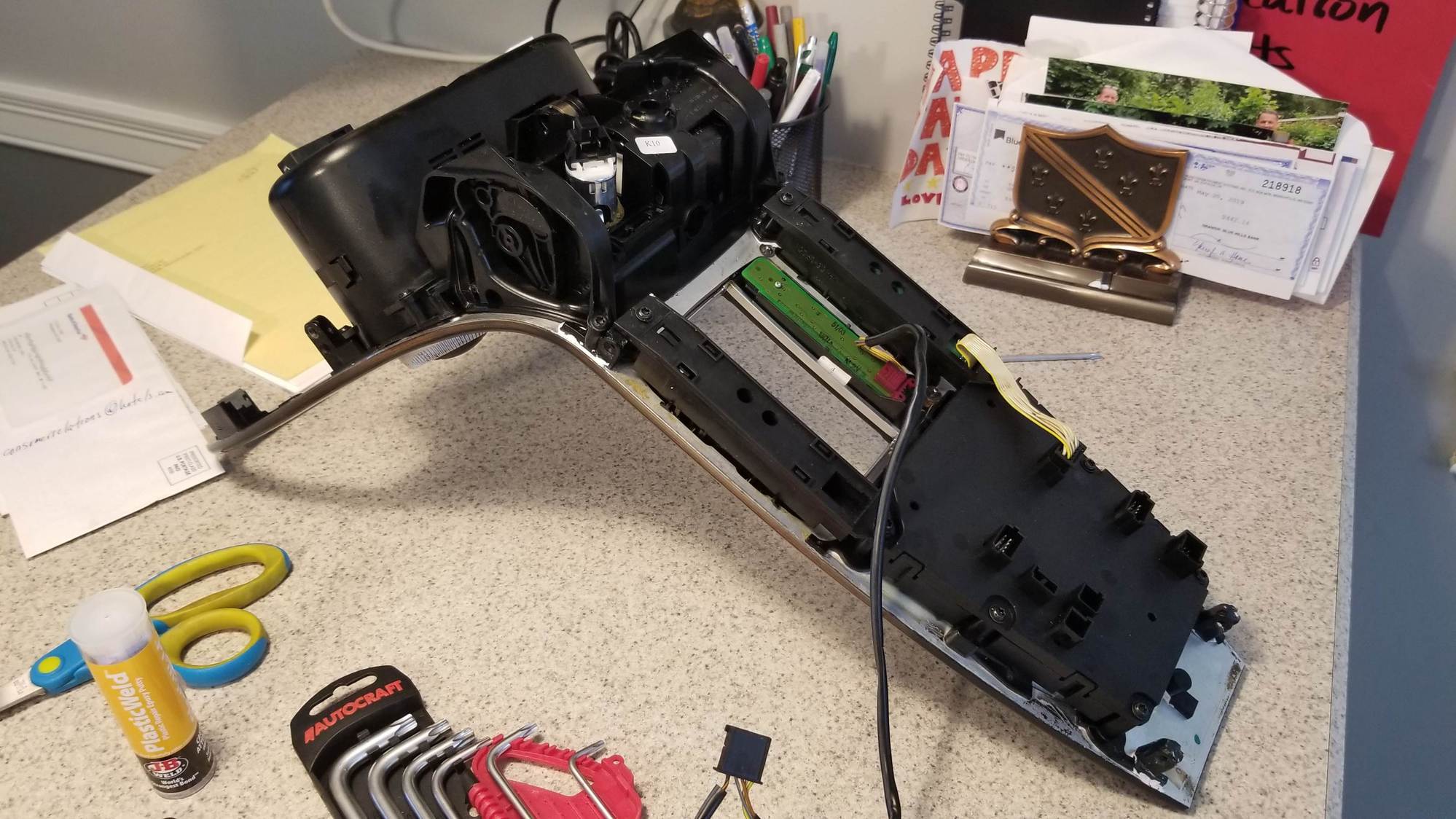

There are videos on YouTube, search on "removing COMAND", that show you how to remove the console. The CC is attached to the console trim, you need to unscrew it off of there. Here's a picture of the back of my center console trim with the CC attached (big smooth black box towards the left):

just in case he can't read the MB WIS document

Well, motion pictures can sometimes make things more clear.
