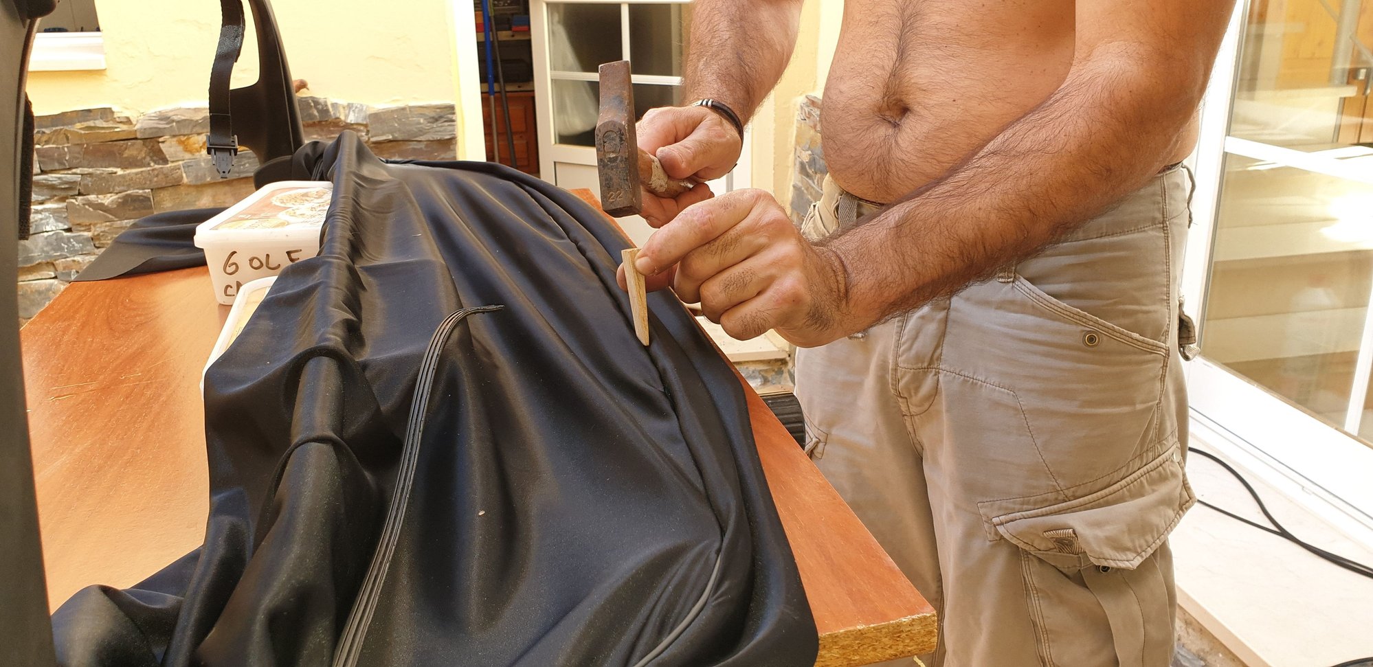

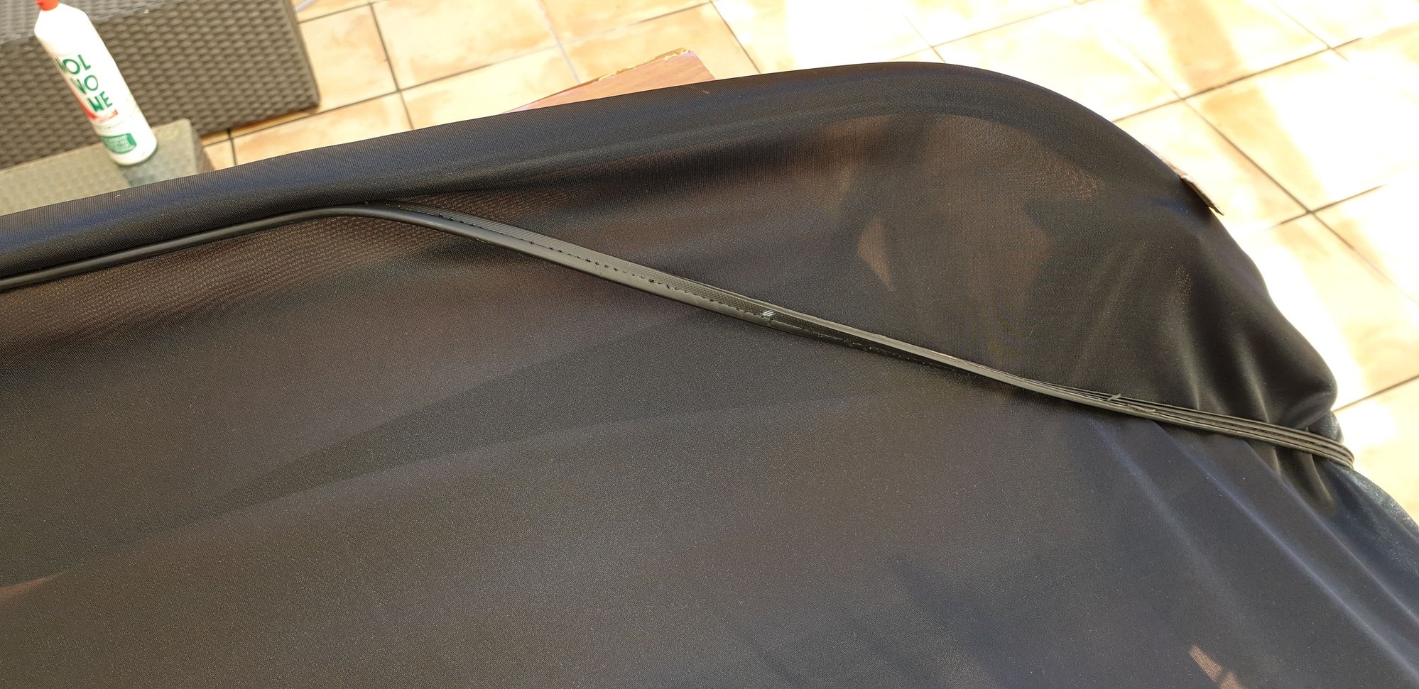

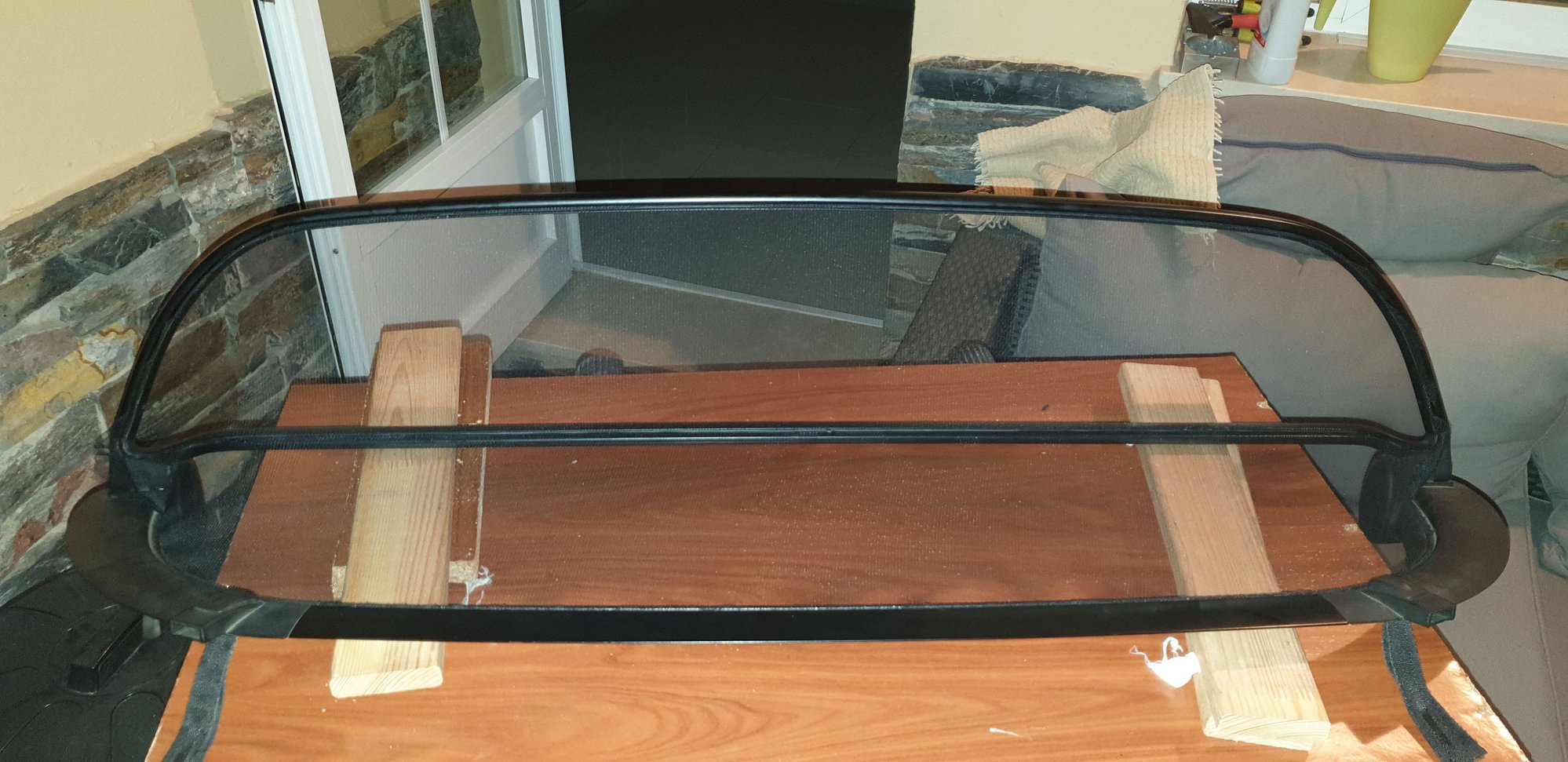

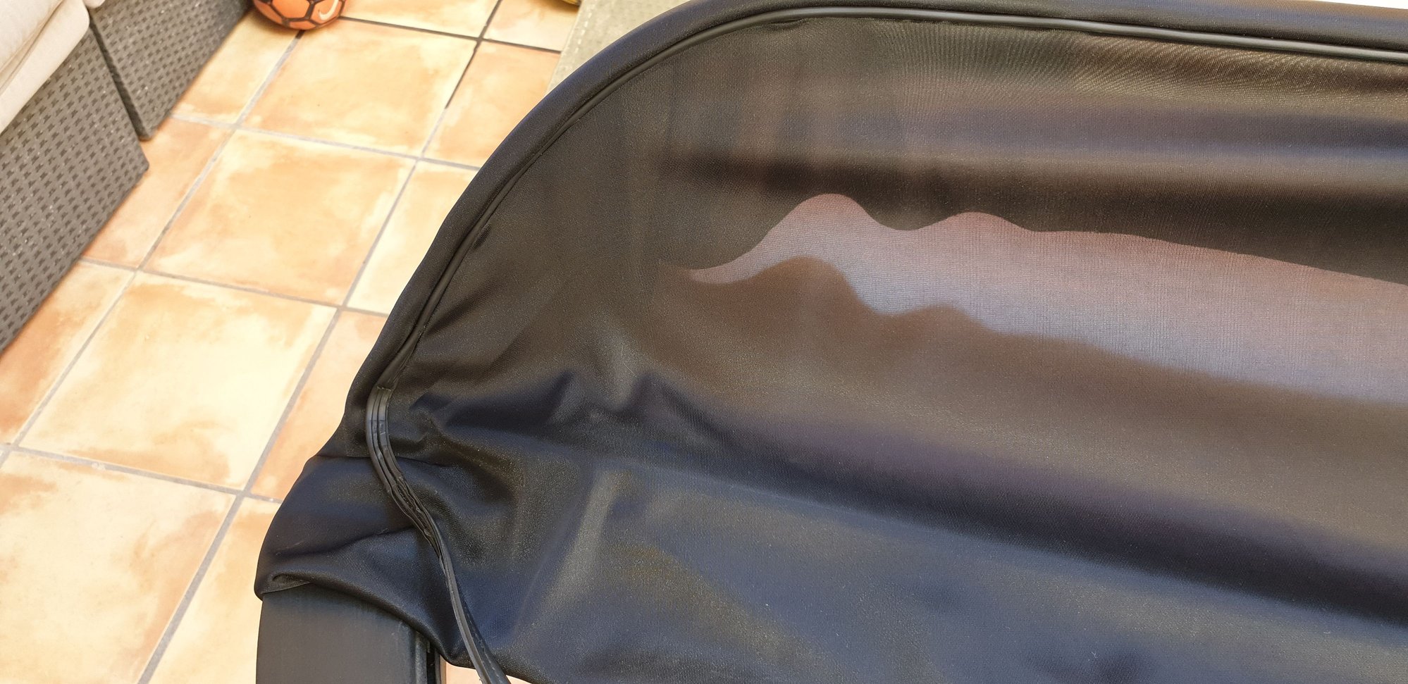

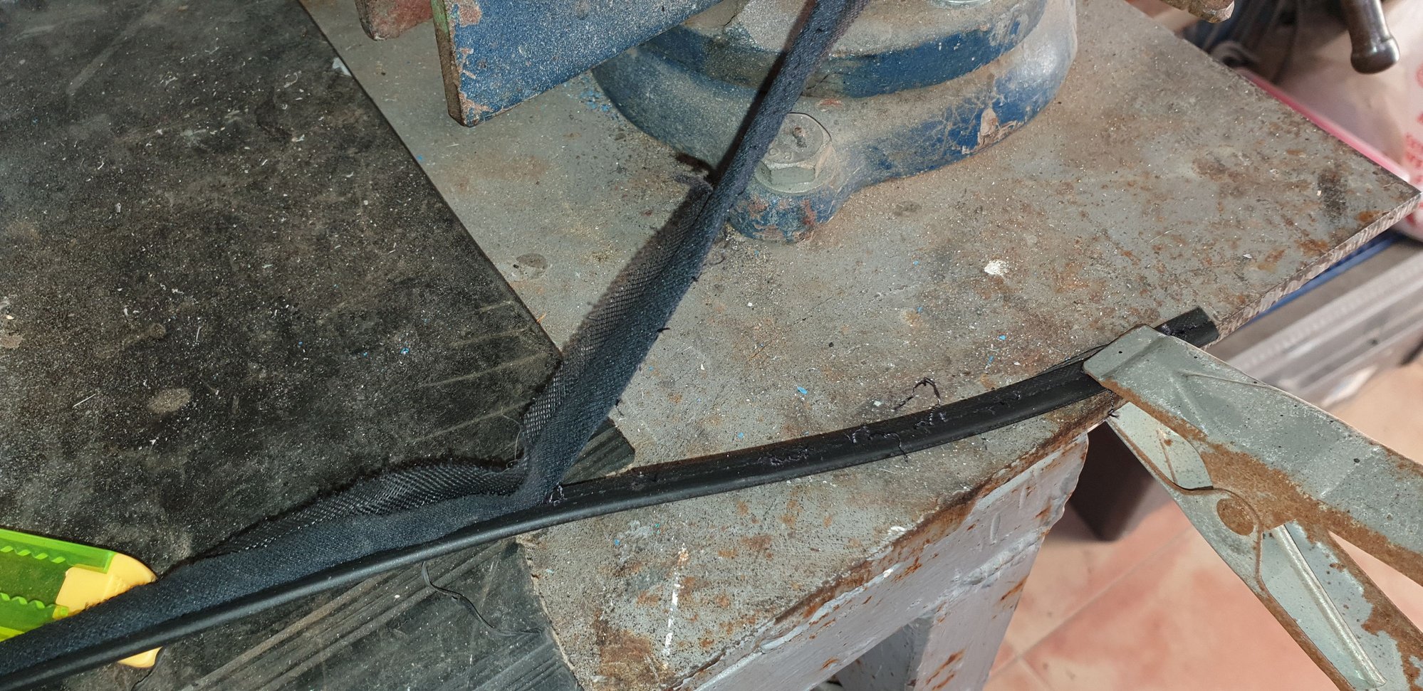

Today I started with the wind deflector that had the broken fabric. Repair is not easy since it is very important to have the special fabric of the deflector, any fabric is not worth it, I used a more transparent fabric to improve vision. you have to remove the broken fabric, then with pliers pliers take out the rubber tape which is what compresses the fabric with the wind deflector so that it does not come loose and tense, once we have the rubber tape out of the deflector of wind we remove the remains of threads and cloth that are left, then we put the new tel on the skeleton of the deflector to present and find the right place and no wrinkles. When this fabric is presented we start to put the rubber tape that is that the fabric makes us firm. When we just put the tape with a hammer and a wooden wedge, we hit it so that it is fixed and does not let the fabric escape, when we have finished we cut the excess fabric. I hope that some partner will yude this post

The cloth that comes from the origin is a piece for the top and the other for the bottom. I have used the same fabric without making any cuts.
