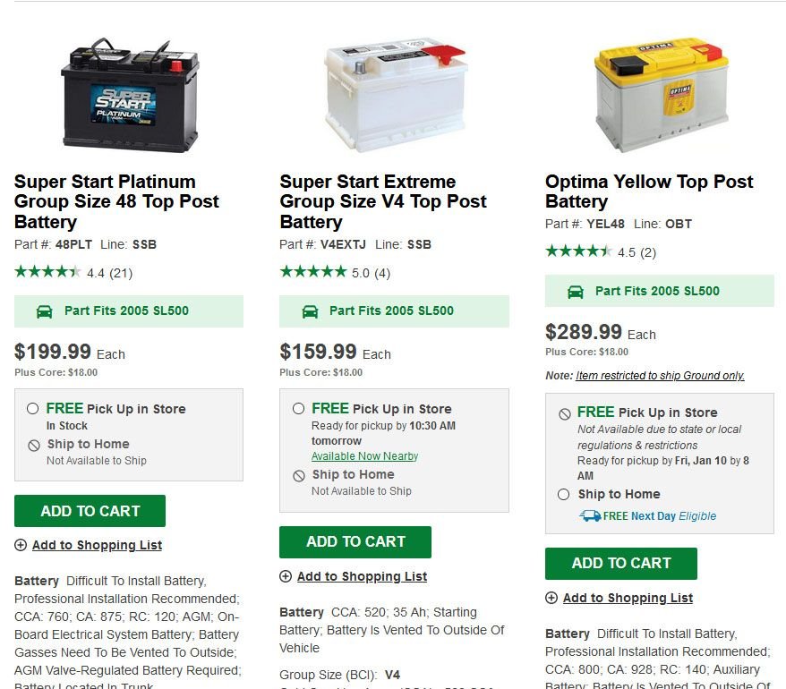

$600 is high, but not that high. expect the Starter battery to cost about $200 and the Consumer battery $250-300. Yes you can get cheaper batteries, but they will no be the same quality or last as long.
$600 for both OEM batteries, installed is not actually that terrible.

Originally Posted by MBCO
Thanks Dudeman for your perspective on pricing. Spoken with SF and CA lens. No doubt accurate within certain zip codes. Meanwhile us residents of often termed "fly-over country" operate with a different lens. If you can fix it your self, do it. If not shop around and spend wisely. E>G> Interstate/Autozone/ ** batteries have same specs (or greater as in Cold Cranking power) as MB batteries, they will start your car and maintain electronics if properly installed and MAINTAINED. (and you don't need a C-tek/MB badged to do it). We in fly-over country are grateful to have lower cost alternatives. Meanwhile, please support your local DEALERSHIPS in CA, and let us know how your next "dealership experience" goes. Less there be no confusion, all MB owners should take recalls, extended warranties, particularly BRAKING and SAFETY issues to the dealer as they are they BEST and ONLY solution in may cases.
I appreciate sarcasm like any other guy, but If you would bother just for one moment to get of your high horse, and check one of those places you mentioned, you will find that the prices I was mentioning are pretty accurate.
O-Reilley Auto Parts (same as AutoZone), sells the starter battery for $200, and the consumer battery for $290. That's just $10 shy of $500, and if you ever did install the starter battery, in the Sl500, you would know it's not an easy one to do, in fact it's a pain the ***.
https://www.oreillyauto.com/shop/b/b...4/31624da3221a
So yes, I think $600 for genuine Mercedes parts, with installation is a damn good deal. But by all means, please show show US how much money you would save on these batteries in your neck of the woods.
Made a call to a local dealer, quoted $800 + tax for both batteries installed. Save $300 if DIY, instructions available on these boards. Perhaps CA dealers have sharper pencils on batteries? Didn't mean to come off sarcastic, just not a fan of dealers, for things other than recalls, warranties, and complex repairs.
FWIW, it was the OP that mentioned the dealer offered to do both batteries for $600 while they were working on his SBC. He thought it was high, and I chimed in that the $600 price tag was reasonable, if you consider the cost of the actual batteries and the cost of labor.
