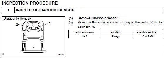

You can test parkings sensors like this:
Ohms might be different from one model to another but if you test all you will find the failing
