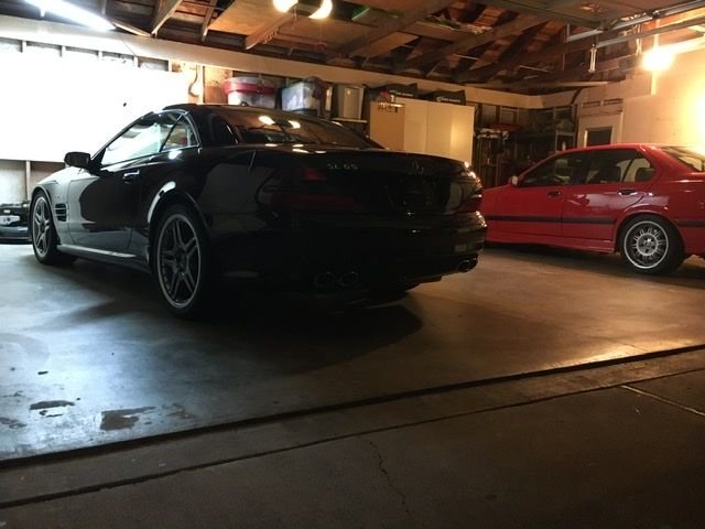

Have some leftover wheels from my R8 and wanted to see if they fit. Looks like they should clear with a 8-10mm spacer. Any of you know of spacers/adapters that changes the bore from Audi to Mercedes?

The bore of the Audi wheel is smaller than the MB. You would most likely need to have your wheels center bored
