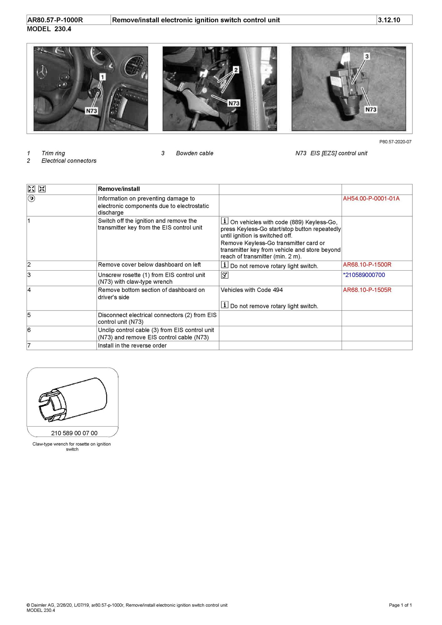

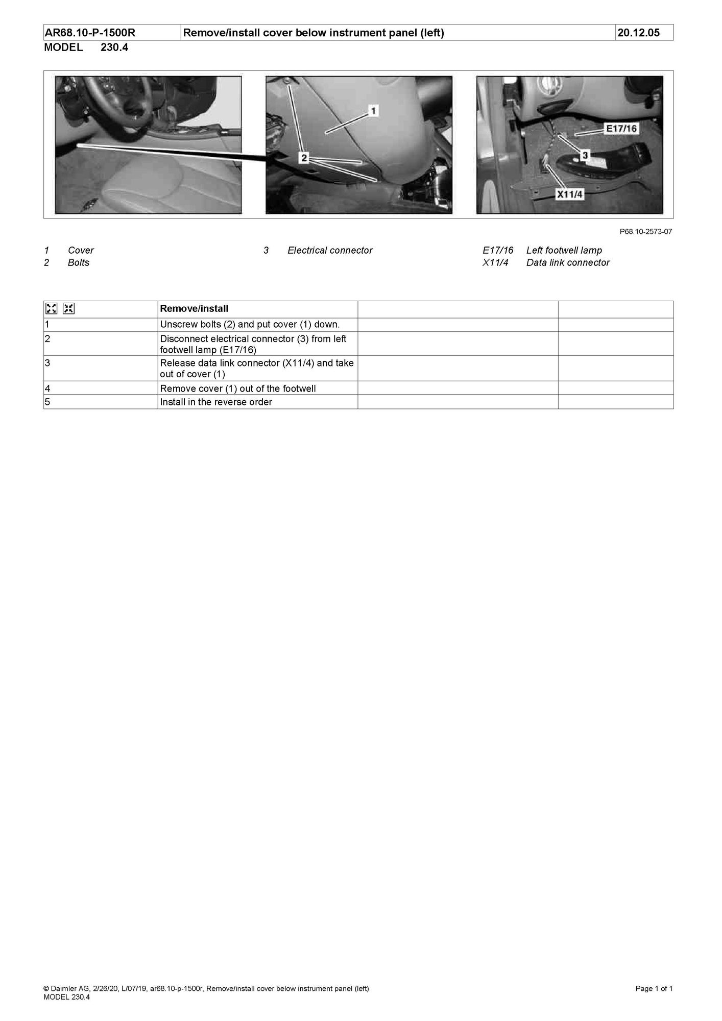

then, if both keys do the same you can only be sure what is going on with Xentry/Das
here documentation, hope it will help you
