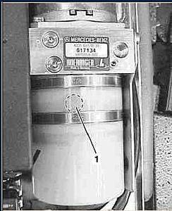

Mercedes issued a service bulletin to its dealers on resolving noisy, slow hydraulics operation. According to that bulletin, a possible cause is: "An air bubble is present above the upper intake hole in the expansion reservoir of the hydraulic unit" (picture).
The solution is to unbolt the pump assembly, separate the electrical connector, prop up the assembly with the motor end raised, reconnect the electrical connector, and then operate the roof several times.
That procedure has never benefited me, but being so quick and easy to do, it seems like a worthwhile starting point.
Thanks for the tip. I tried and it didn't work for me. Now trunk lid cannot move from upright position to close position without a little finger push, from close position to upright position, it worked fast.
