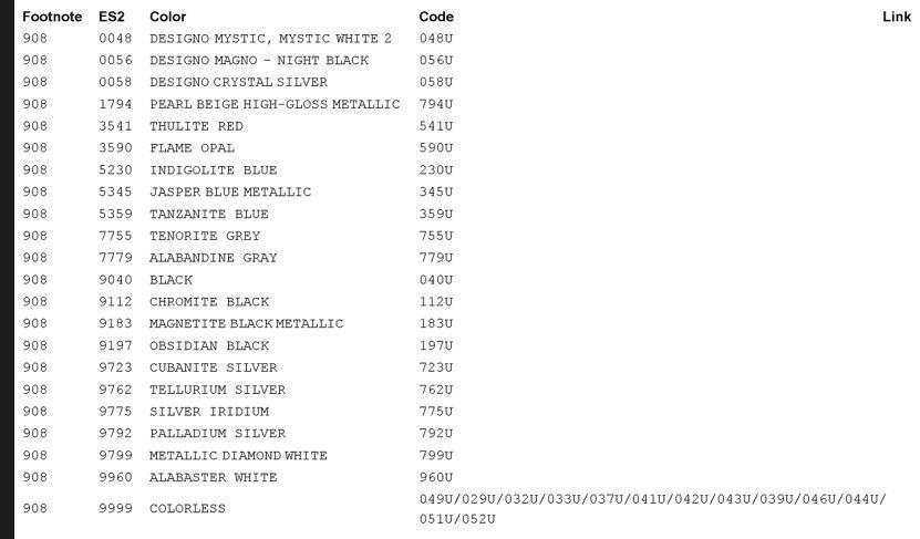

these should do it
but you will have to code out the lights. or leave them in then behind the bumper
A2308851121
A2308851221
