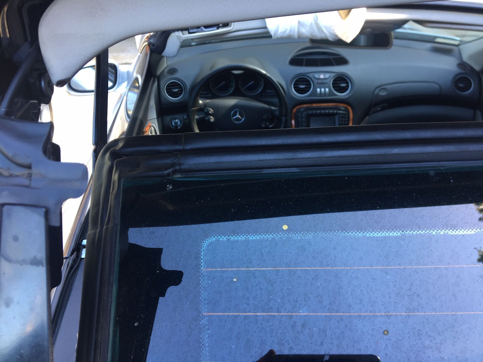

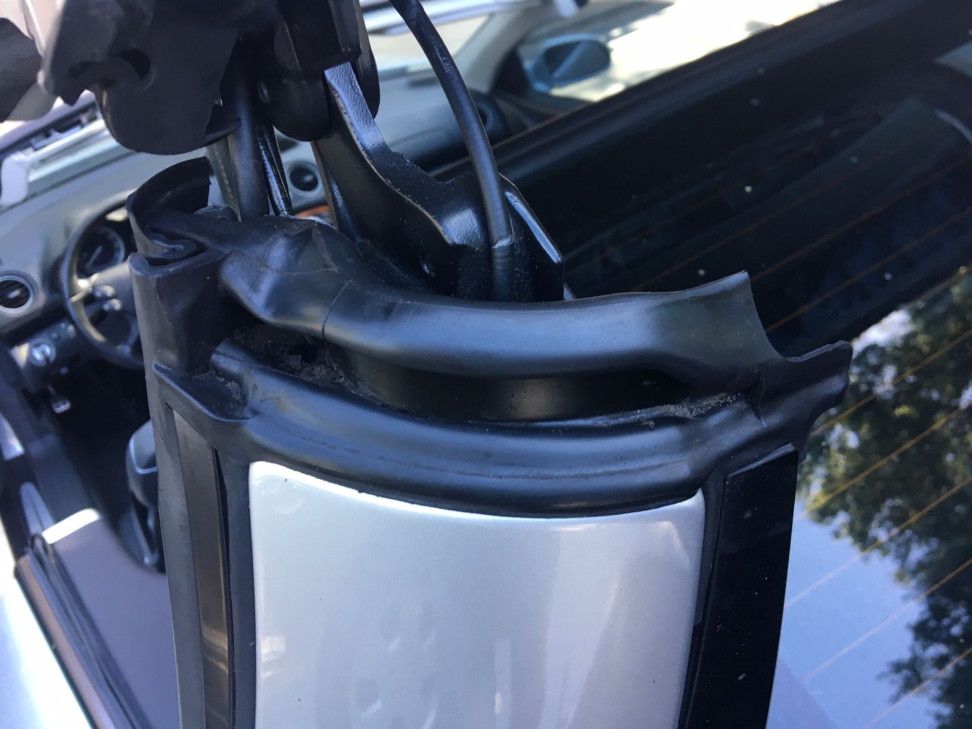

Hi, countless posts on the vario top leaks (mostly trunk), but I can't find any clear information on the leak behind the driver seat, which seems to be coming from the top of the C pillar. All cleaning, Gummi Pfelge treatments already done. The draining passage from the roof top to the door level (rubber along the metal part of the C pillar) and down to the ground is clear. Alignment of panels seems to be good and the same on both sides. No visible rubber damage or deformation. Still there is a leak on the driver side.
I enclose the photos below of the relevant area. Could someone please mark on an photo the typical water entry point and the best way to stop it? Thanks a lot!

OK, I had this too and it stumped me for ages. However look in the area of the arrow, inside the recess of the seal and you will see a very small hole. It’s difficult to see, I didn’t pick up on it straight away. This is the entrance to a drain that runs internally down the length of the seal. I put a plastic strimmer wire down the top hole and gently pushed it down till it exited through the bottom of the seal. You will need to externally massage the seal at various points to get the wire to move past some points. Do not just use brute force.
After the strimmer wire appeared at the bottom of the seal I moved it up and down a few times to clear any crap and then pulled it out. My leak stopped straight after.
Coincidentally my leak started after I’d done a session cleaning all the seals and treating with gummi fledge. My theory is that while I was cleaning the insides of the seal join, I’ve managed to dislodge some dirt that has entered into that drain hole.

Thanks @matk , this is exactly what I have been looking for! Indeed there is a hole, which I was expecting but could not find it as it points in the direction from inside of the car out, so not visible from a side. I've cleared it now so hopefully this is it :-). It seems the hole joins the big top to bottom opening inside the C pillar seal, which I have already cleared earlier by pushing a suitable plastic wire from the top. Thanks again!

Make sure you clean the complete length of the drain tube. If you don’t and there is some crap at the bottom end, it will appear that it’s fixed, but what happens is water will back up the tube and it will leak again
