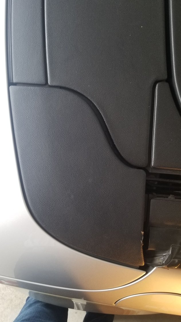

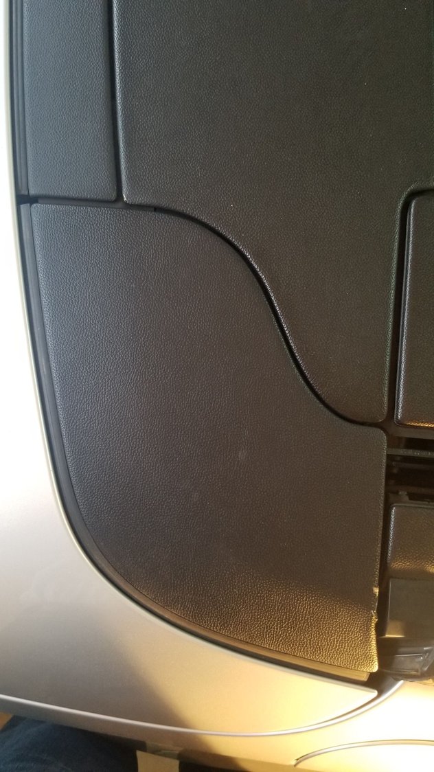

My trunk flaps were way out of alignment. When closing the trunk the flaps would contact the trim with the little flaps, I would have to hold them up and close the trunk carefully.

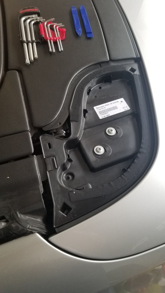

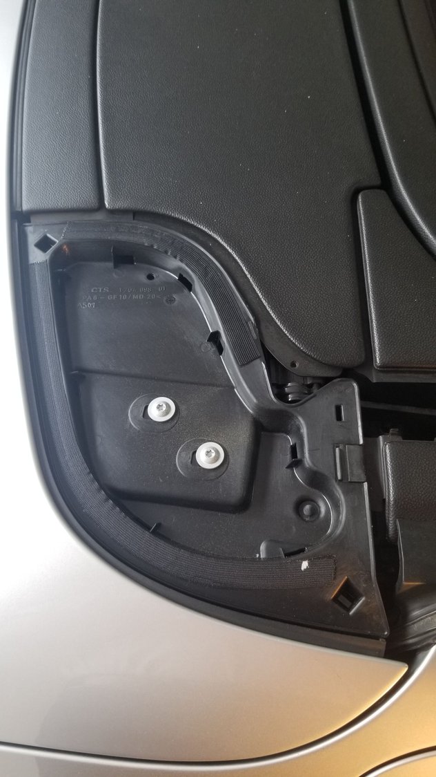

I followed these instructions:
https://youtu.be/67vWSEUMpRU

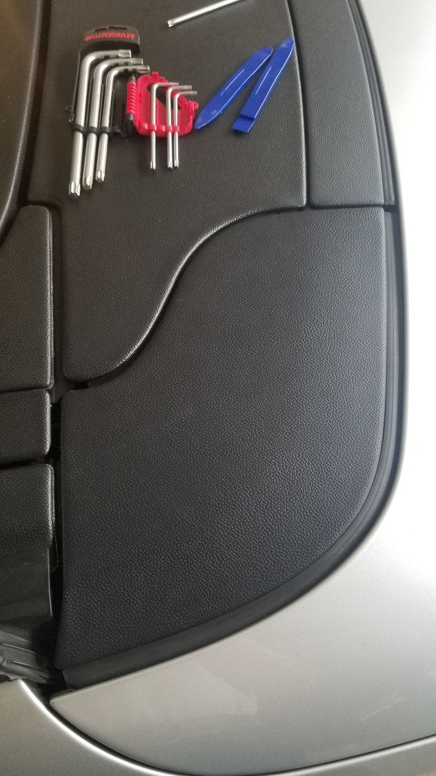

The entire job was 10-15 minutes. I used a T27 torx and 2 trim tools to wedge and unclip the covers.
